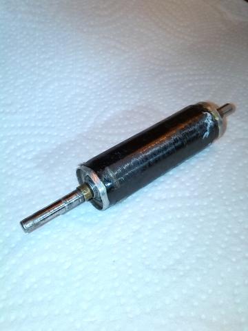

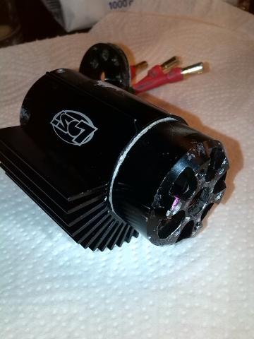

as the front bearing broke, I had to replace the bearing and I also cleaned the motor.
The motor is an equivalent to the Leopard 4082 Motor.
When I ordered the motor, I made a mistake as I chose a kind of "Lightweight" type of motor without a seperate front plate.
Well, I closed all holes with aluminium tape and silicone.
Compared to the Leo's, these motors are packed with copper from front to end.
I have also a smaller 3674 type-of TP Motor, which is also fully packed with copper. The small motor has 2000kv, but compared to a Leo 4074 more torque.
This motor here is a TP 4050L 1750 V2 motor. The "normal" versions have bigger bearings, so an other reason not to choose the light motor version.
I heave forgotten to measure the rotor, but I guess it's about 50mm long, total length is 80 mm.
The carbon-fiber is a little damaged due to the bearing, I have fixed that with a little CA glue (worked well in the past).
On the carbon, there is also some clear coat.
Fortunately I had bought some expensive SKF bearings ages ago, which fit (5x11mm).
