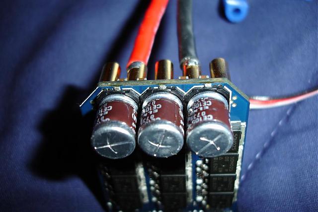

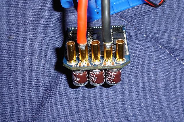

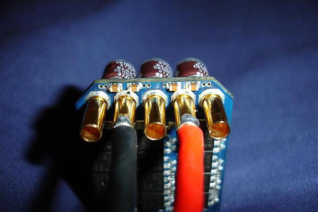

02.07.2008, 08:29 PM
Ok you guys, here are some pics...

02.07.2008, 08:35 PM
Yeah, a voltage divider may work like you want, but you really have to make sure that the IC pin you are looking at is indeed the v sense pin. Is there a part number on that IC? Many ESCs scratch off the part number on the main brain IC. Not to mention that the brain may just be a PIC and those inputs are programmable. I would definitely wait for Griffin to add his input before attempting anything.

02.07.2008, 08:44 PM
Here what the IC Pin says...
50N025
06 P
Triangle BW
L62k
Maybe you guys can help me grasp what all this means?
