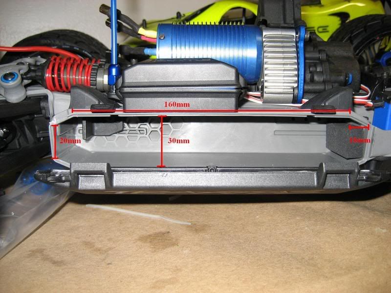

I took some measurements when I was wondering the same thing...
You can't read it very well but the measurement on the right is 10mm
So you can do 30X165X51 or 20X180X51
good luck with the search
