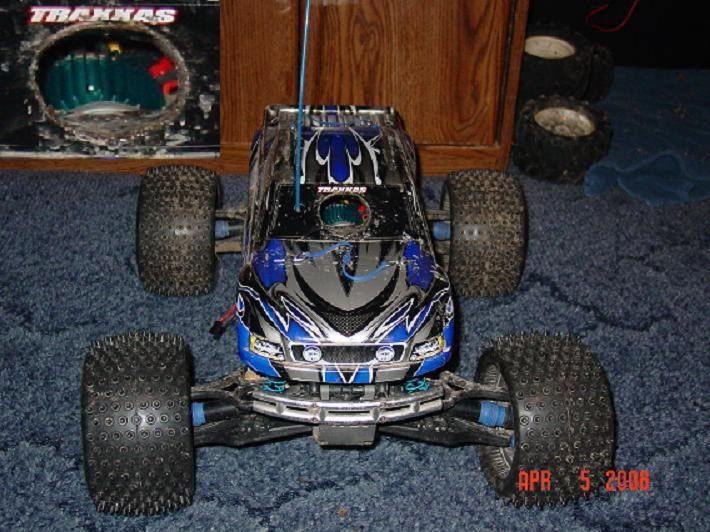

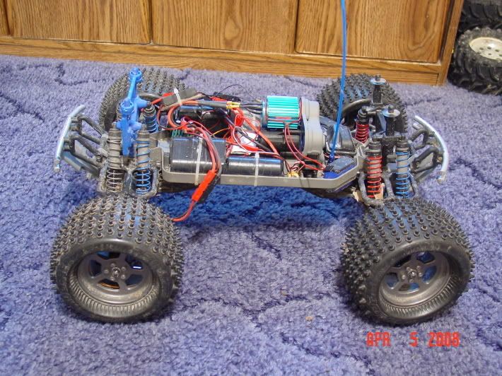

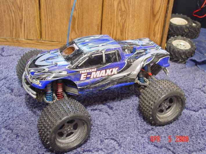

Any way some pics of the test rig.

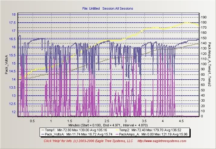

I have a few logs from the Ammo before I put on the heat sink and installed the cooling duct so I want to retest that motor once I find the limits on the Medusa.

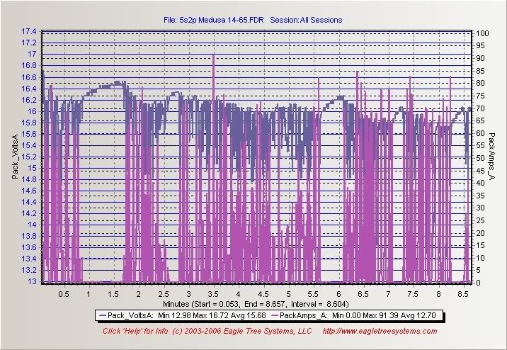

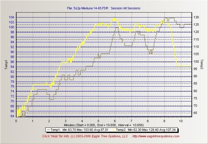

I did a little rearranging and harvested a small fan from a laptop for the ESC, it was getting up to ~140 yesterday with ambiant temps in the low 60's, so I turned it 90deg heatsink forward from the pics in the first post(hard to see with all the wires) and if that isn't enough I'll hook up the fan. I'd like to see it about 60deg above ambiant. Got bored waiting for the sun to come up this morning, LOL.

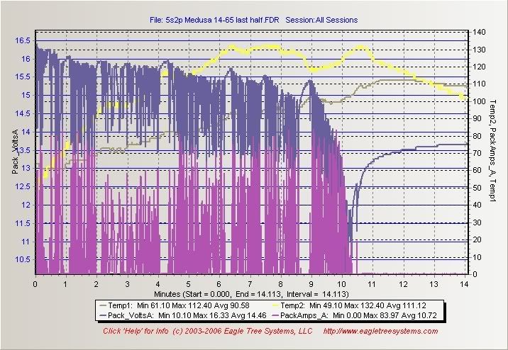

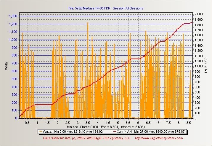

Ok graphs with the 14/65 gears, I split up the data so the graphs aren't so messy.
Temp1 is the motor temp2 the ESC.
I could probably push it harder yet, but ambiant was 43f when I made this run so I think this is the limit. Speed was decent up a little from the 68t spur, darn near cleared the down slope on the far side of the road, wheelies up to maybe 10-12mph. Stuttered on one start up. I'll turn up the start power and see if it helps. Then back to the Ammo for the heads up portion of this thread.

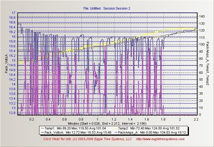

Ok here is a graph with the Ammo on the same 14/65 gear set, only other change was I went back to low start power on the ESC.
Even though the motor is running well outside its comfort zone it was putting down big power, at least 5mph faster than the Medusa, more torque, it's like it's a much higher KV motor. I'm going to gear down till it feels close to the same speed as the Medusa and see how the temps are.

Wow I'm down to an 11t pinion the Ammo is still as fast as the Medusa on 14/65 maybe even a touch faster, torque is better, lifts the front end much easier at higher speeds, but the temps dont want to drop. Maybe a drop in timing advance would help at this point??

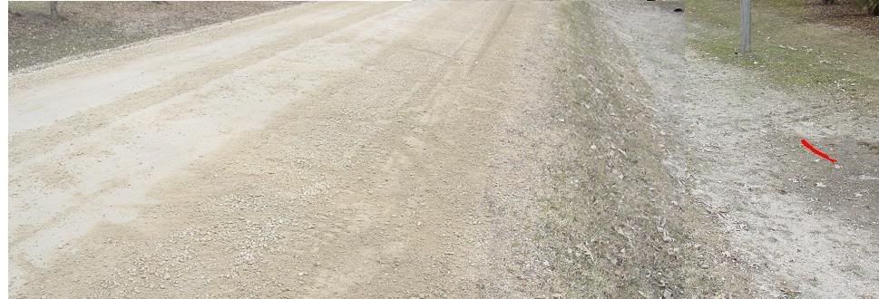

Pic of the distance I've been launching it today.
The red line is the first point of contact
