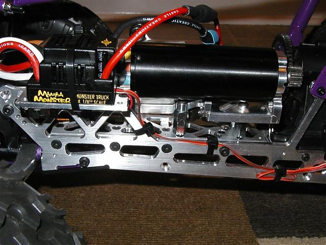

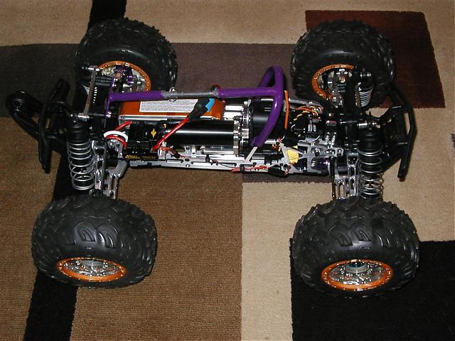

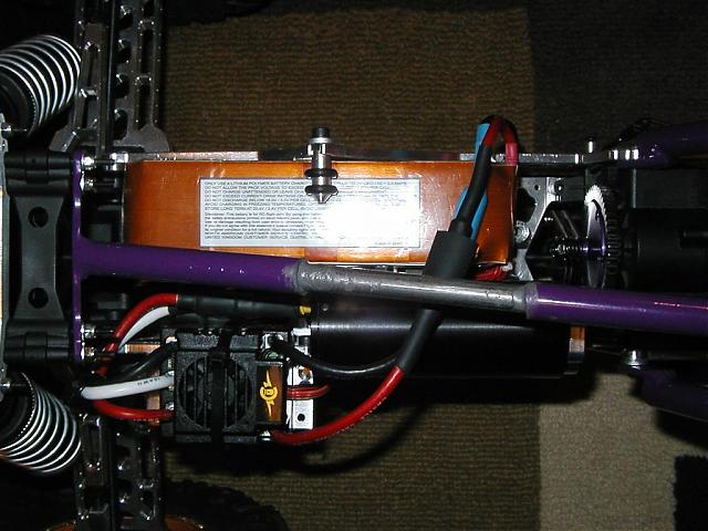

For everyone worried about the Monster's ability to handle high amps, well don't worry at all. I have run 4 packs of 6S 5000mAH Flightpowers through the setup below with no problems. No high temps either. It is a Neu 1527 1D (2300kv), so on 6S it pushes about 51,000 RPM. And sucks current fast! My servos are a 5955 (333oz/in) and a 645 (133oz/in). No BEC problems either. Great job Castle! Sorry about the nasty looking roll bar, but hey, it works. Now to finish the rebuild, new bumpers, new wheelie bar 2 dogbones twisted etc. etc. etc. Diffs are holding up great-go figure!?!?!?

It weighs just over 15 pounds with the battery. I run a 52/13 ratio for bashing and the motor gets warm, not hot. The same with the ESC, just warm to the touch. I tried a 52/20 ratio for a speed run and just did not have the space or the control to get to full throttle. LOL-at the end of the run the truck tumbled for about 30 feet even after slowing down. I don't know enough to set up for high speed runs, but I might learn to, they are a blast! I have my Eagletree in my heli but it only goes to 100 amps max. I'm sure it's pulling more than that. I just bought a video camera so when I can get it away from the wife I will shoot a few clips.
Thanks again to Castle for a great product and thanks,also, to HPI. This Savage drivetrain is amazingly tough! If you do a conversion, get the diffs with the alloy case and steel pin inserts then add the optional hardened ring and pinion setup (R+P is $30 a set but well worth it). For the tranny, the Hot Racing 44 tooth hardened steel internal spur gear is a must. It all adds up to a very robust drivetrain.
