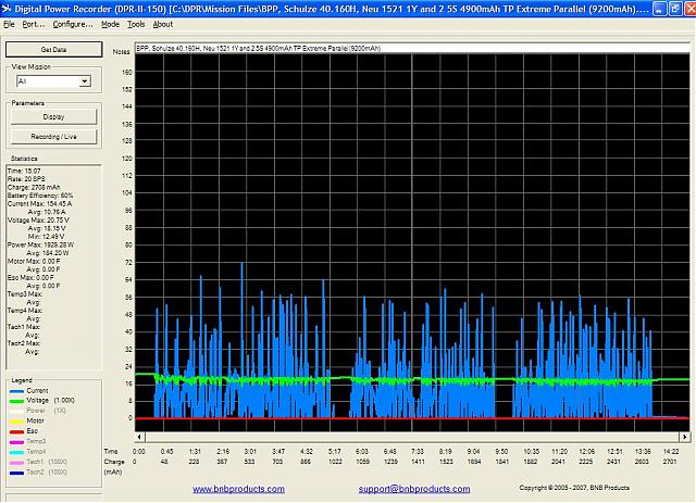

lutach- what's your guesstimate on the number of amps you're putting through the schulze on those runs. what else have you run on the 13lb trucks...
Here is the link that shows the graph with 10S lipos with the 1521/1Y: http://www.rc-monster.com/forum/show...0&postcount=90. The graph posted here is with the same batteries in parallel.
Name:	BPP, Schulze 40.160H, Neu 1521 1Y and 2 5S 4900mAh TP Extreme Parallel (9200mAh).jpg

On my 8S/10S A123 setup i draw 65A max FWIW. Stays cool no matter how long or how hard I drive it.
