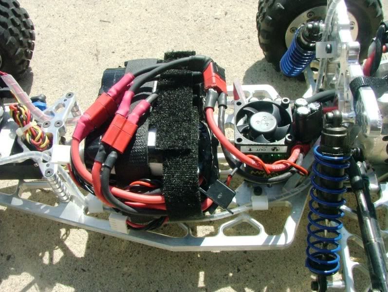

They will not fit properly in the stock location as they are bigger then Sub-C. But A123 will be releasing a smaller pack that will fit. If you get the FLM chassis that Mike carries, then A123 cells will fit. Look at the 2 pictures below and you'll see that they won't fit properly.
This is two 3s1p packs
This is two 2s1p packs
6 KiloWatt A123 Racer
24s2p EVG SX 49.6mph Ebike.

12.17.2007, 05:45 PM
REALLY nice clean packaging on that Rusto, snellemin. A picture paints a thousand words....
12.18.2007, 04:21 PM
Hehe, I take it there was a pinch or sarcasm with that? I couldnt see the cells in the 1st pic for the velrco & wires! Anyway, A123 cells are a fair bit longer & wider than Sub-C, so fitting them is a nightmare. An after market chassis would be best (the FLM is cheap and very cheerful), that way you could lay them out and strap them down with plenty room to spare, just wont be as neat as the proper chassis with the 'tub' for the batteries to sit inside....

ICUBoy
Posts: 79
12.18.2007, 10:57 PM
Suicideneil I might be revealing my lack of experience and skill but that really IS clean compared to my emaxx with MM, BEC, Feigao, A123s: it's a big old mess really. The A123s are salvaged from deWalt packs and look like homemade bombs... But it is fun!!
12.19.2007, 10:19 AM
Hehehe, I think theres just an excess of wire in the first pic, but thats not an issue really since sometimes its better to have too much than not enough. I've seen far worse before, so that looks okay by comparision!

12.19.2007, 01:55 PM
I'm waiting for the extended chassis to arrive. Hopefully my cable routing will look better after that hehheheheh. Really hard to fit 6 A123 cells on the current chassis. I'm hoping that the extended chassis will wheelie less and have a better straightline run.
