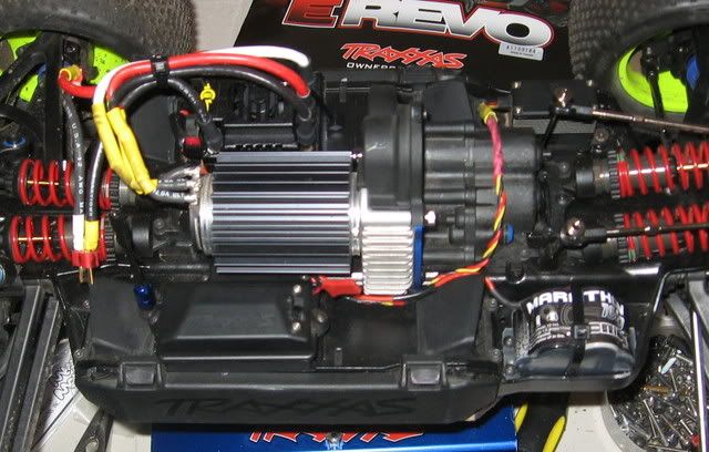

ok here is what i am running
mmm - rx pack backfeeding the esc. so it works
4s
12/68
hvmaxx 4.5 motor
erevo
default settings except for 13.2v lvc
batterys 105*
mmm , fan was coming on and off when ran hard
motor 130* at the heatsink
any thoughts on temps?
can i go up to a 13 tooth gear?
not a 1515 1y , but it should be good on the track

Looks like it runs nice. Seems to me you could go up a tooth or 2 no problem. The bat and motor temps are fine and the MMM can take "more than you can handle" so there shouldn't be a problem there.

i ran it with a 11t to begin with and needed more............
ill try a 13 and see how what the temps do
good news is it has an 1/8th in. shaft so pinions are like $3
i think it is pretty close to 38mph or so now
i ran for 15 min and didnt see any slow down yet (lvc @ 13.2v) so 20 min. on my 5k packs may be in sight
