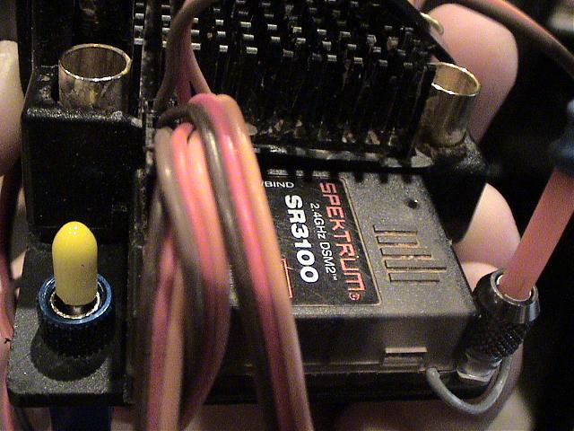

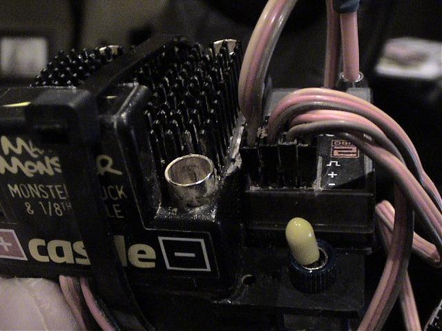

thanks for the tips DriftBuggy and BrianG. here is my newly mounted radioshack toggle switch....modified, of course. instead of the nuts and washers it comes with i used a knurled aluminum knob from an antenna kit. i also cut the handle on the switch down a bit. i dont want it to flip off if i end up on my shell. i actually had to cut the aluminum nut down a bit too so it would fit nice. anyway, works great and looks cool too, if i do say so myself.
