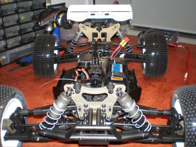

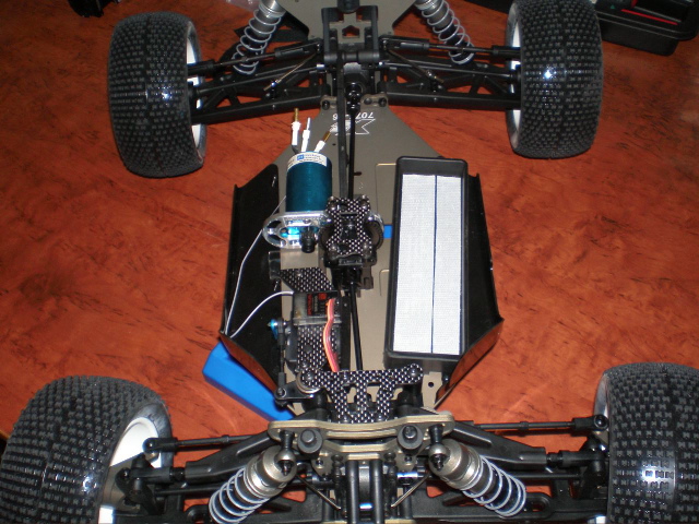

Hey guys .
Following on from conversations and PMs with some of you on RCTech i finally joined here .
My X2 is finished , waiting on the body to be painted and another esc.
Fried the MM when testing the X2 on the bench
Have back ordered a couple of MMM V2 ( one will go in my RC8 conversion ) and will be trying one of Arturs Modded R1Pros out .I can always sell the second MMM if not needed .

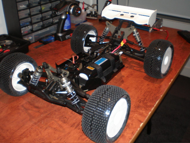

Following set up
PQ 5S 4350mah
Medusa 36-60 1600kv motor with 14 t - 15 t pinion ( 38 - 40 mph )
RCM battery tray
TeknoRC universal motor mount
MMM V2 or modded R1 Pro
Everything went smoothly in the build and have to say the driveline is the smoothest i have ever built , very nice

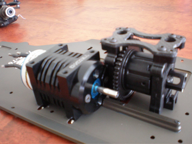

Only mod i had to make was for the Tekno mount .The mount itself is a very niece pice of work , cradles the Medusa like a glove and works as a heat sink .

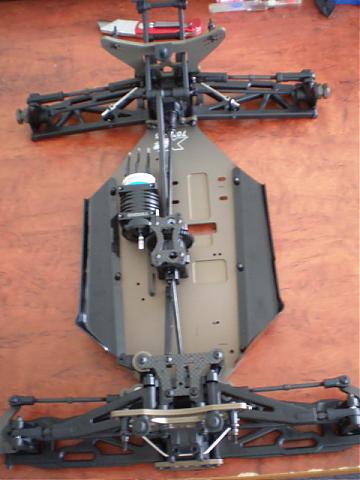

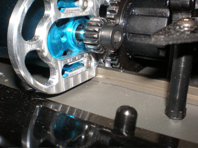

I had to make 4 countersunk slots in the chassis for the mount so i could adjust gear mesh .
Also since the mount is seperate from the diff any flex in the centre of the chassis would disturb the mesh and could destroy the pinion / spur . I came up with the idea of using Traxxas steel pushrods ( plenty of guys on RCTech gave me some good ideas on bracing the diff ) and attached two pushrods to the top of the diff and rear chassis brace .
This should work well until Mike comes out with an X2 specific mount so i wont need the bracing .

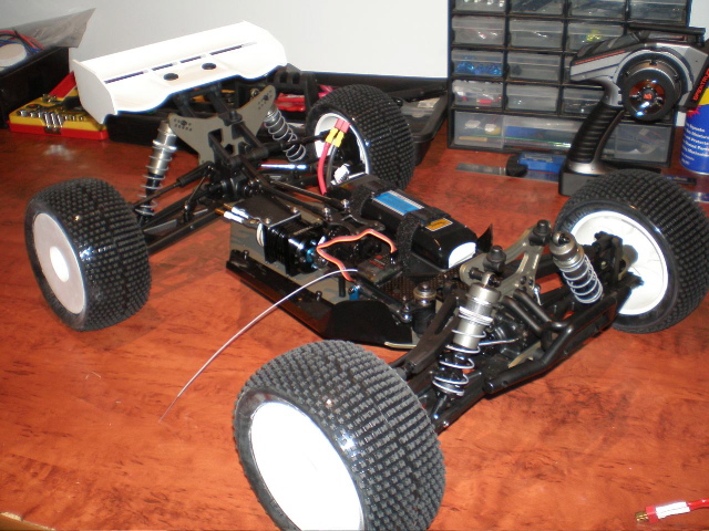

On another note , after a few emails with Mike he was sure a couple of guys are already using the CR mount in the X2 so i ordered one to try out.

Very very nice. I envy u. Me all talk but no action . The rear brace is plastic isn't it ? Maybe good idea to upgrade to an Al one.

Joe i'm waiting to see if i can fit the CR mount so i can take the bracing away .If it won't fit i will upgrade to the alloy F/R chassis braces .

How did u mount the Tekno motor mount ffactory? I have an x1 i would like to have one of those on it.
ffactory666
08.07.2008, 05:45 PM
You have to make 4 countersunk slots in the chassis for the mount and to allow gear mesh adjustment.
I just measured up drilled two holes ( make sure they are the right size for the screws ) were each slot starts and ends and then completed the slot with a dremel milling bit
Of course then i used a countersink bit . Dont forget though if using this mount you have to brace you centre diff somehow like i did .

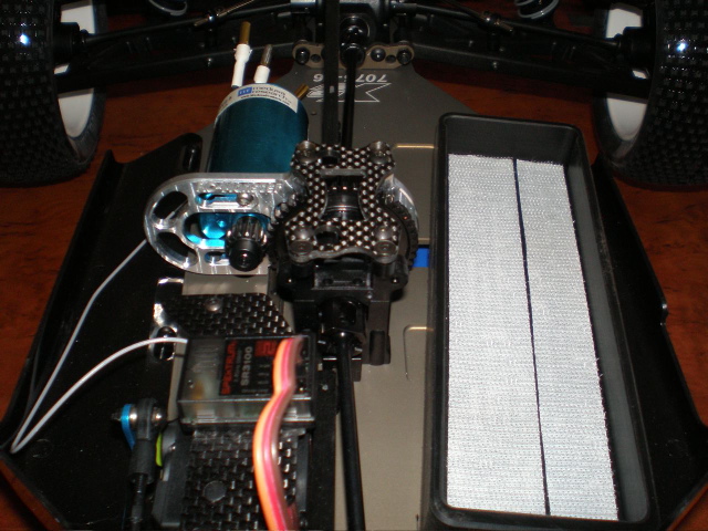

Got a little present from Mike today
Needless to say i can now confirm for you guys that the CR buggy mount fits the X2
Just need to take the dremmel and put a notch in it were it sits on the center chassis brace for clearance .
You can see it in the pic .
Also Mikes mount is about 1mm taller than the stock diff mount so you just have to shim the top of the stock mount so the top diff plate sits square . Bearing carrier is spot on .
Now i have gotten rid of the centre diff braces i had to use on the Tekno mount, a lot cleaner looking
Also received my custom one piece battery trays , perfect .
They clear the diff nicely , sit on the mudguard spot on and best of all i can now use my Zippy packs along with the enerland cells .
After speaking to Jeff i also got the front wall of the tray machined thicker for those hard lawn dart accidents

Looks great! Keep us updated on how it runs. Does the spur gear go wider than the motor mount? Thats what it looks like in the picture... I just noticed it because usually his motor mounts are just a touch wider than the spur gear, so that the battery tray can be as close as possible and it looks like you have quite a bit of extra room to push the battery a little closer toward the center.
ffactory666
08.08.2008, 03:38 AM
Just checked for you .
Looks like the spur is borderline with the end of mount .
That pic does make the tray look like it's got a mile between it and the spur , just measured it has 3mm clearance. I could move it over a touch more , within 1mm of the spur but don't want to in case of an accident , wouldn't want that spur anywere near the lipo .
How much clearance do you have between tray and spur ?
jnev
jnev's Avatar
Posts: 2,864
08.08.2008, 03:50 AM
On my 8ight, I'd say there is about 1/2 to 3/4 of a millimeter clearance between the tray and motor mount. But the motor mount goes about 2 to 3 mm past the spur gear. So I think thats a fairly safe distance. Yah, looking back at the picture, it definitely makes it look more than 3mm.
ffactory666
08.08.2008, 03:52 AM
Sweet i'll keep it at that distance then .
Understand what you mean though , if the mount came past the spur it would act like a guard
