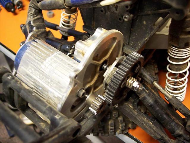

i just finished putting new bearings in my 9l, got a new spur gear, new drvie shafts and replaced my right drive yoke today so i threw the badlands on there and went to to play a little, and i was doing back flips about 20' long and a couple feet over my head in height, which is pretty normal stuff and all, so after about the 10th flips it goes upside down and i gas it to bring it on around and POW the tranny just exploded and locked the wheels up in mid air! here is waht she it looks like, and it also ripped the left driveyoke off.....
anyone wanna guess what it messed up while i take it apart?
my guess is i sheared the top shaft and lost a couple bearings, and possibly the idler gear...it sounds bad lol

My guess is the idler blew... then lodged itself in the other gears , good job though :D

close.... actually its was the input shaft that sheared off its dowel pin and then its pieces killed the idler gear and the input gear. so now im trying to get whats left of the dowel pin out and i have another idler gear and the input gear isnt too bad its unusable, so if i can get another dowel pin in this input shaft ill be back in business because i dont have another one of those...

well i got what was left of the dowel pin out, i didnt have another the right size so i found a drill bit that was .0015 too big, cut it the right length and beat it on home... you can see part of where the input gear got eatin up a little, i guess i need to order another inputshaft because i dunno how long the drill bit will last.

I have drilled my input shafts to 2.5mm and used the revo yoke setscrew (cut the threaded portion off) in orde to strengthen that area. Then you need to dremel the idler gear gap to allow fitment of the bigger pin.

I've busted a few of them too. Then I replaced it with a drive pin from the wheel hubs and *poof* no more problems! That was well over 2 years ago and it's still going strong. That hollow pin they use really isn't meant for brushless-grade torque! I have noticed my input bearing is getting a little sloppy (the spur/slipper wiggles a little bit), or maybe it's the bearing recess in the FLM case?

Seriously, just use one of your extra wheel hex drive pins. They are SOLID and HARDENED. Two qualities the original roll pin didn't have. I actually put a very slight bend in mine when I installed it to make sure it didn't slide out.
