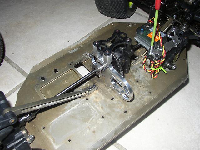

gutted all those dirty nitro parts today and added mikes conversion kit and mounted reciver still waiting on more parts, ordered a mamba monster and a zippys 5000mah 5sp and will be getting bec and motor soon as more money comes in from selling parts off my old isuzu truck i blew the motor, so far it has been funding me well so far so good just wanted to keep ya guys posted on the progress here are some pics of what i have so far im gonna run the stock diffs and spur and see how it works out before changing
