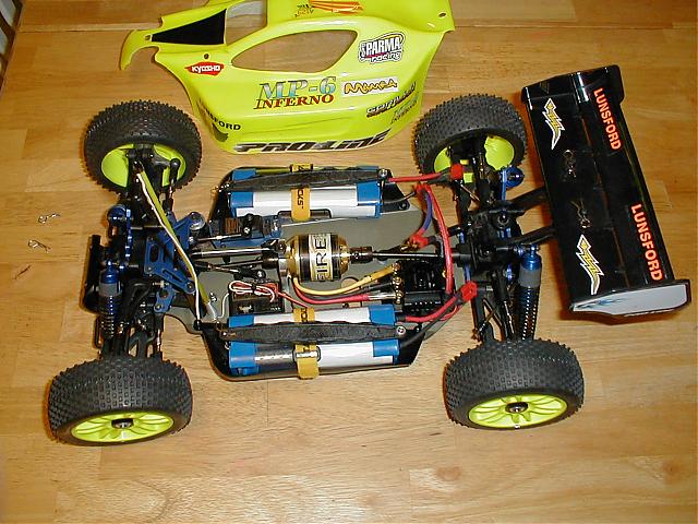

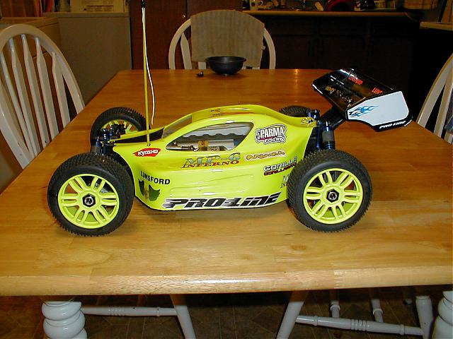

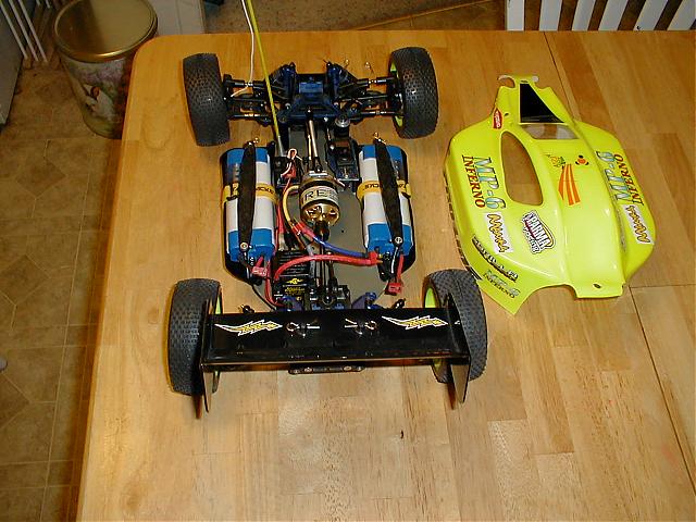

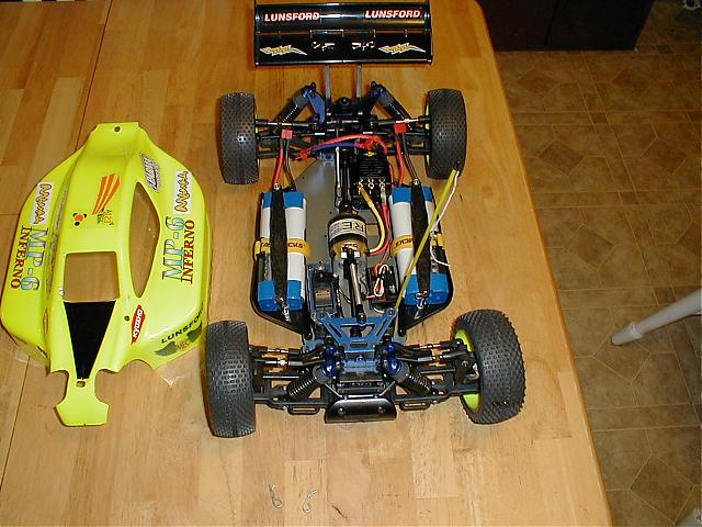

Just finished my MP-6. Thanks to RCMonster Mike for the excellent motor mount! I've yet to fire it up- I hope the MMM handles the outrunner ok. It weighs 7.75 lbs. I hope I can get 20 minutes on a charge. Power is 6s A123. Don

11.10.2008, 12:21 PM

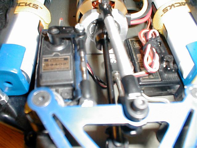

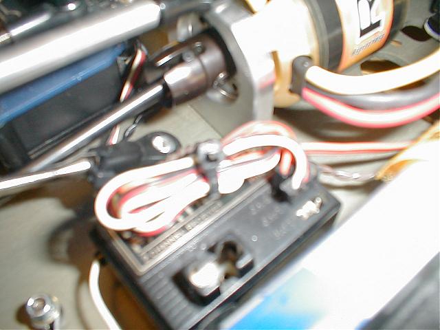

Looks good, any chance of some closer pics of the outrunner and mount?
DLS II
Posts: 136
11.10.2008, 12:43 PM
Sure- a little fuzzy though. Don

pumpkinfish
Posts: 69
Join Date: Jun 2007
11.10.2008, 02:48 PM
What is the advantage of outrunner?
DLS II
Posts: 136
11.10.2008, 03:08 PM
I wanted to see if I could make a buggy with an outrunner replacing the center diff. They produce a lot of torque and it's low KV (600) helps keep current draw down. Now I've got to program the MMM for a 12volt cutoff and set up the Tx. Then-dirt! Don

othello
HV basher
Posts: 392
Join Date: Jun 2007
Location: Austria (Europe)
11.10.2008, 10:35 PM
Interesting (light wheight) built. Which motor did you choose exactly? 600kv with 6s A123 (about 18V @ 600kv = 10800 rpm) seems to be perfect to replace an inrunner with 32000-35000rpm. Shall give you decent speed.
Report back when you fire it up. 20 minutes will be hard to reach on a track -> 2,2A x 3 = 6,6A x 18V = 118,8 Watt average. Almost 1/3 of what i used in my "heavier" buggy with 10s A123 geared for 42mph and running 13-15 minutes.
DLS II
Posts: 136
11.11.2008, 08:38 AM
The motor is a GP Rimfire 42-60-600. IR is .029 and no load current is 2.5 amps. Maximum constant current is 40 amps and surge is 70 amps-but those figures are for an airplane propped. I wanted to set it up 8s, but the MMM will only take 7s. Your math is interesting, but I don't quite follow it? If I thought it would take off enough weight I would seriously look at getting a carbon fiber chassis made.(provided of course I didn't have to take a second mortgage on the house!) The run time is only a hope! Thanks, Don
