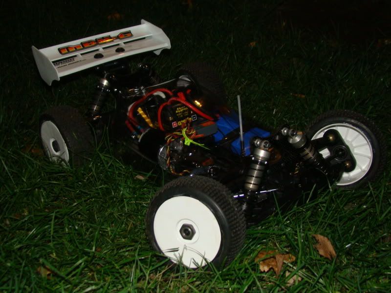

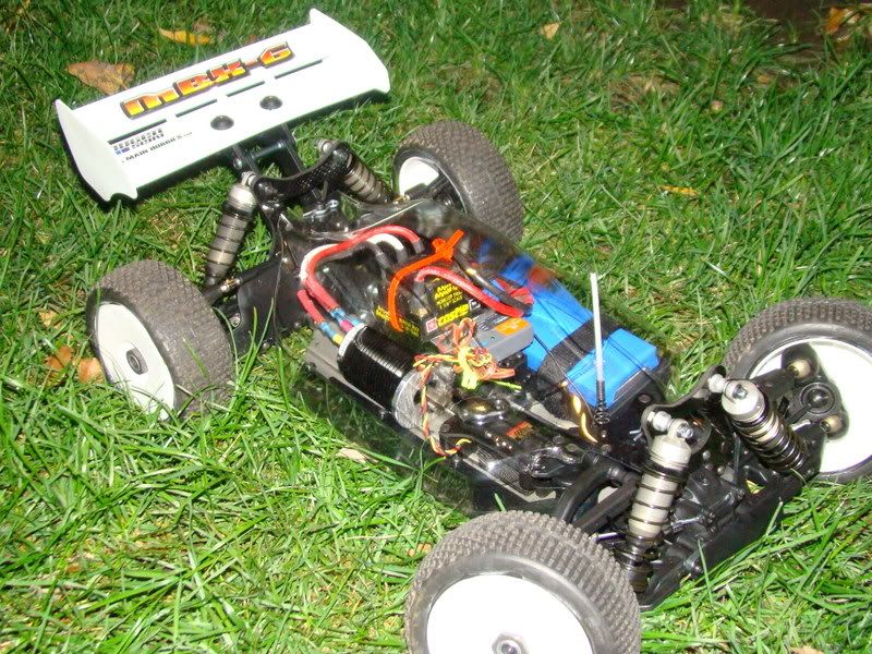

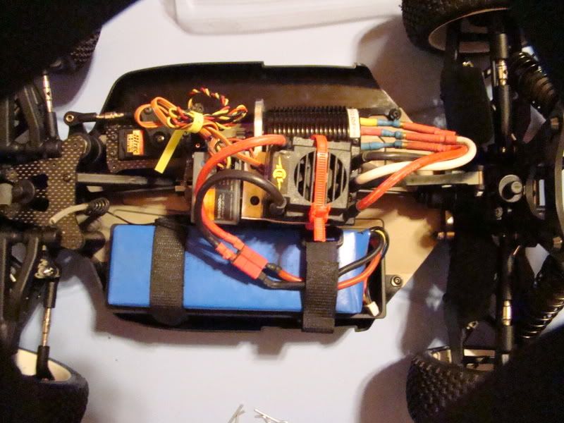

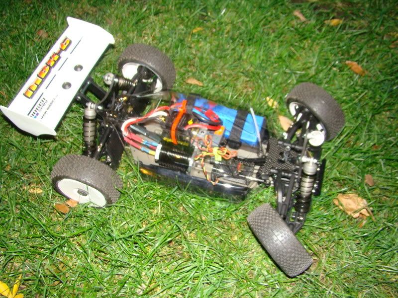

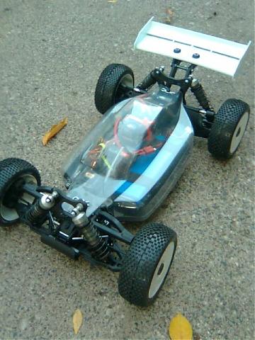

So apparently I wasn't the first to have one...but I sure was close
Just a few bad pictures I took with my phone. I will take some with the Canon later in the week.
All I can say is....
This thing is awesome.

Just doing some running in my front and back yard yesterday. I really want to make it to a track, thats all i'm going to say.
Temps were
MMM: 100F
1512 2.5D:140F
Lipo(4S Zippy 5000):105F
My lipo's always seem to run slightly hotter than they really should. Is it an MMM setting I should change or what? I charge the lipos with the equinox balancer in interface mode, and I still get these high temps. The packs feel a little soft after the runs too.
It doesn't make sense as these packs are not very old and haven't been ran much at all. If they are sitting around for more than a week I will balance charge them.
Is it time for new packs?
Well anyways upon running, and keeping in mind i'll be racing this winter, I think I want to step up to 5S and gear lower.
I am going to say that the MBX-6 has performed flawlessly. It seems like the drivetrain has loosened up quite a bit and it is very smooth now. But I do hear a "squeeky" noise coming from the front somewhere when the wheels spin, I can't find out where it is coming from. But there is no binding, so it might just go away. Could be a bearing, but I doubt it.

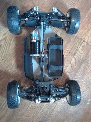

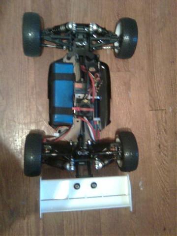

What motor mount are you using? Any issues with the stock kit diff mount on the other side? I mean, how much did you have to shim either one. Also, how did you mount your battery tray? I should have my MBX6 tomorrow and I'm trying to figure out what else I need. My 777 conversion was easy because I used an RCPD kit.
Steve Krug
Steve Krug's Avatar
Posts: 125
10.25.2008, 04:40 PM
Originally Posted by pumpkinfish View Post
Steve,
I'm using the RCM Mugen motor mount.
I actually did not shim the diff at all. It seems like there is no slop at all. All you really need is the RCM motor mount, and a battery tray.
I'm using the RCM battery tray and put a few shims on the bottom of the tray before mounting them using 3 of the stock chassis holes. I just split the stock radio tray in half just for the steering servo also. - actually, everything has taken alot of abuse so far with no breakage.
Hope this helps, feel free to ask any more questions.

What's the purpose of splitting the stock radio tray in half? I'm not getting this? Do you have any pics?
Also what kind of gears do you need for a successful conversion? Thanks
Steve Krug
Steve Krug's Avatar
Posts: 125
11.08.2008, 09:40 PM
You have to split the stock radio tray in half for these conversions because otherwise it'll get in the way of the motor. There is no after market steering servo mount for the MBX6 at the moment.
Not sure what you mean by what kind of gears.
I run the RCM pinion gears, and all the other gears (spur, diffs) are all stock.
