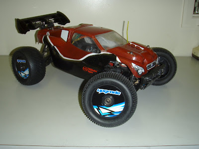

I have a brushless Thunder Tiger ST-1 Pro. I've been racing it since mid October last year, plus a decent amount of running up and down the street and on grass.
I can't remember all the things that are different between the RTR and the Pro, but besides the stock body and a set of center diff gears I shimmed wrong I haven't had to replace anything on it yet, so it seems pretty strong to me.
I use a neu 1515 2.5d and 95% of the racing has been done on 5s, with maybe half of the bashing on 6s, so the drivetrain seems pretty decent.

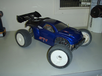

[IMG][/IMG]
Original body.

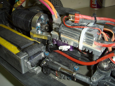

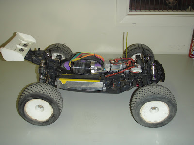

Hand made motor mount and battery trays. Esc mount is the rcm one made for the quark 125.
[IMG][/IMG]

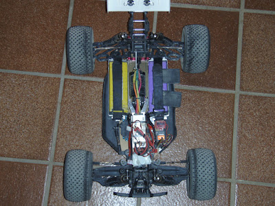

Ignore the messy wiring and foam hanging off the side.
[IMG][/IMG]

It wasn't really that hard to make the motor mount, just time consuming, but it depends on how much of that sort of stuff you've done before. If you haven't done much it's not the easiest thing to start with.
I used at hacksaw, a few different files, various drill bits, cheap drill press (I did a few of the holes with a normal drill, but it's a bit harder), dremel, 4mm tap, fine sand paper and finally a buffing wheel on a bench grinder to make it look pretty.

The motor adjustment slots are a bit tricky. I marked out where I wanted the slots, then drilled a line of 3mm holes as close together as possible, and used the dremel with a router type bit (I don't know the exact name for it) to get rid of the remaining material.
If you do one like mine or the rc monster mounts then it also holds one of the center diff bearings, so you want all of that to be as staight as possible, otherwise the center diff will sit at an angle.
If you make a mount like cart213's (I assume his is the other ST-1 you saw) it still uses the stock diff holder on both sides, so it won't have to hold the center diff bearing.

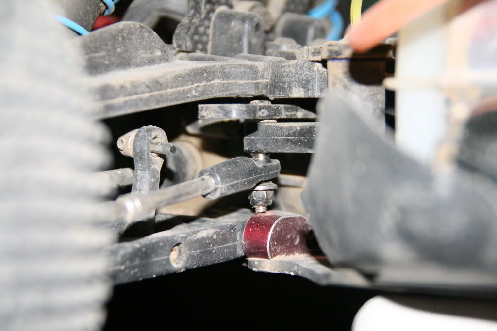

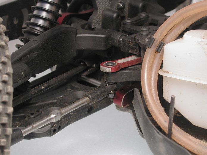

Should end up looking like this.
joeling said in that thread that you don't actually need to cut the steering ackerman for it to work.

Here are some photos I took just now on the steering mod result :

cool thanks joeling so basically all you did was move the tie rods to the inner mounts. awesome Iwas trying to figure out how to make it turn better!
