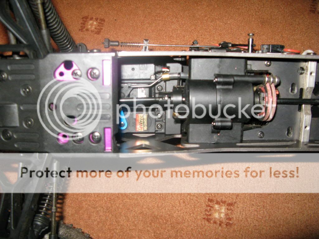

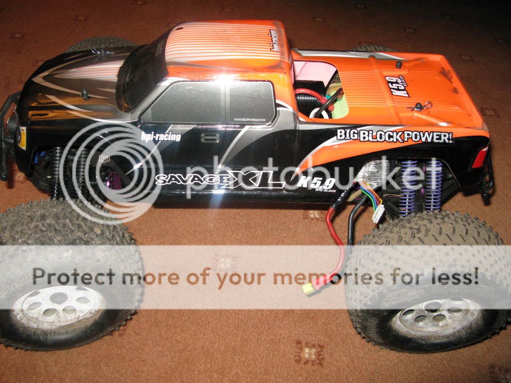

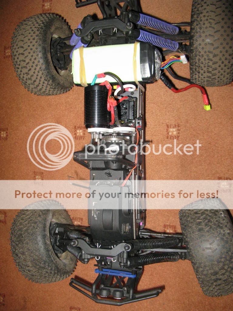

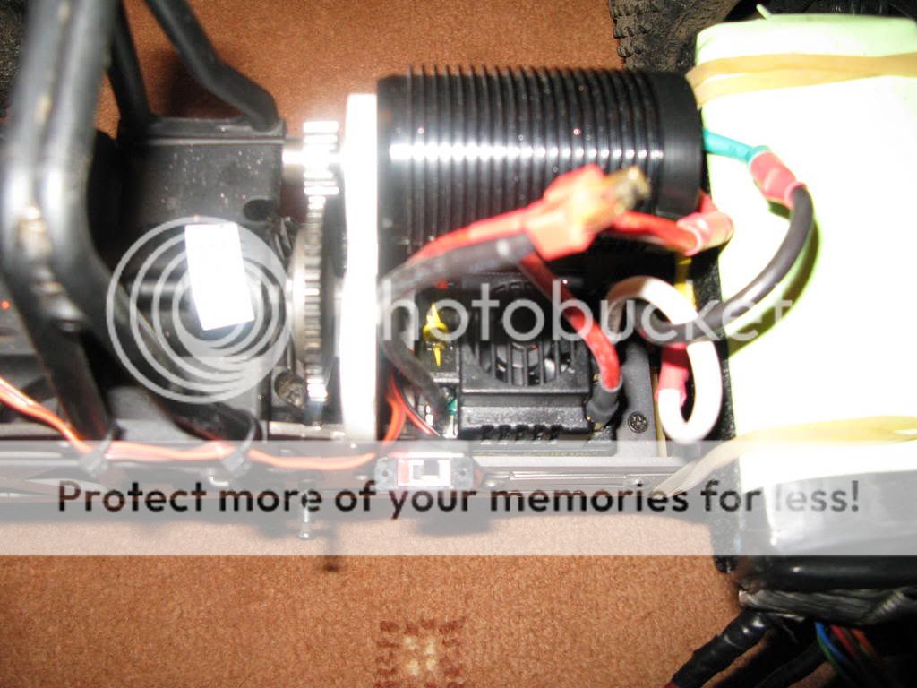

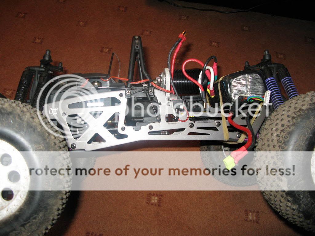

Some pictures of the installation. As you can see the battery is temp tied down with a rubber band on the back of the frames. This actually keeps the truck balanced. If I can find a way of fitting a battery tray in this location I might go for this. My original plan was to install 2 Battery trays on the side frames.
