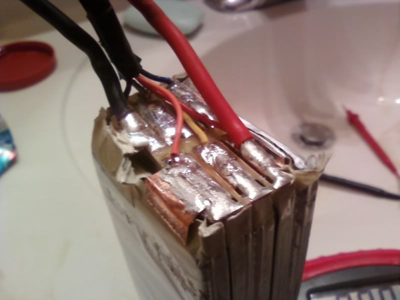

just got a couple of the zippy brand lipo's and just wanted to know, is the chip necessary? or can it be removed. my speed control has a cutoff already or does it have something to do with keeping ballance. sorry guys new to the zippys

sorry guys here is a pic

What the hell is that. Does it attach to the balance tabs? My Zippys didnt have that.

Yes it can be removed, when i had my zippy rebuilt it was removed
look closely, offwhite colored board

yeah, i dont know what it is either, but for now i will probably just leave it.
12.11.2008, 08:24 PM
Doesnt lok like a chip to me, looks like that pcb tab connector I mentioned. I would just leave it be.

This isn't a "chip", it is a PCB (Printed Circuit Board) as suicideneil pointed out.
There are two ways to build Lipos, with a PCB or without. Some manufacturers do it one way, others do it the other way. Basically the PCB just makes attaching the cell tabs together a bit cleaner and more manageable. Some manufacturers including soldering points for balance connector wires to be attached on their PCBs, so they don't have to be soldered directly to the cell tabs (the less heat on the cell tabs the better). In some cases PCBs increase the likelihood of a battery going bad, which is typically the result of the PCB cracking due to a crash or hard impact directly on the PCB.
