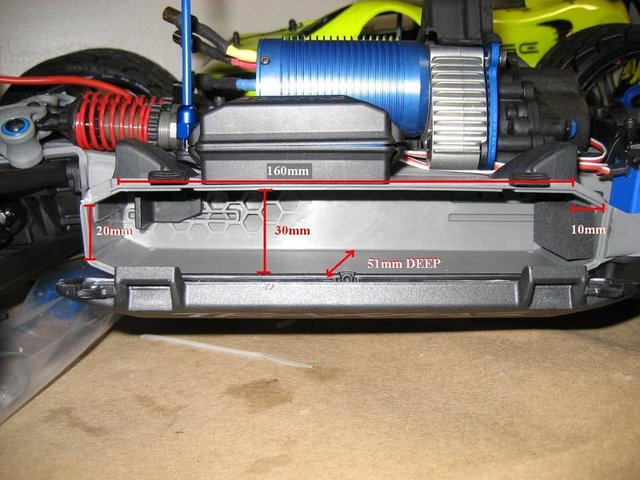

I was going to use this motor in my lst and put the hacker c50 11xl out of the lst into the revo. But then I thought that the revo would be lighter...
Any ideas if the polyquest 6000 3s 25c packs will fit in the erevo battery trays? I remember a great pic with some measurements in it, Neil might have posted it, but I cannot find it right now...

I can not take credit for this pic, only for being smart enough to save it to my computer This is the pic from Neil you where looking for. I just got my NeuEnergy 4900Mah 3s packs and they JUST fit in, take out the sping from the top and the adjustable stop, nothing in the tray except the foam at the front and the battery.
I can't imagine how crazy that setup is going to be Pimp! I just ran mine on 6s and its crazy! MMM/1515 2.5d Tekno Neu/6s NeuEnergy I have it geared 62/22 just over 40MPH, and it's crazy, 20-25MPH wheelies are nothing. I lost a 17mm nut holding my MaximizerBL/Badlands on so I came back in and put the talons back on. It hooks way better on pavement with the talons.
Thanks for the pic. Does not look like the 6000 packs will fit. Hopefully my 4500 30c 3s packs are up to the task.
