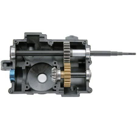

And heres a pic of the tranny with the losi FOC installed, note the lack of any selectors and the case plugs that fill in the reverse gear bearing hole (blue plug on the left side)
Also note that the aftershock comes with the FOC installed stock, it does not have and reverse or high/low gearing in it. So if you find a deal on an aftershock tranny it may be a good purchase.
