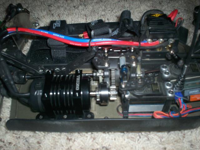

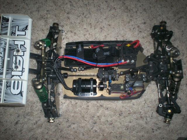

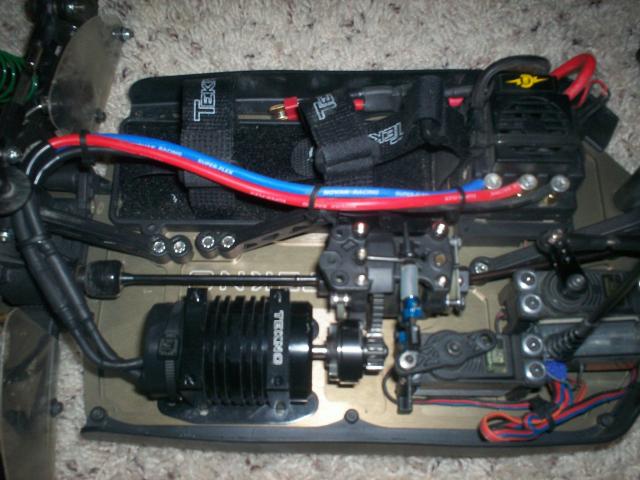

For the motor wire you actually can fit the 4mm females onto the 10 gauge MMM wire. The MMM wires are braided so well that you can fold down each braid (kinda like peeling a banana) and you will have one braid left in the center. Cut that braid and twist the remaining braids together fairly tight and the wire will be able to fit nice and snug into the 4mm connector.
In the pics below you can see I use Novak 12 Gauge wires and changed made the motor wires enter at 90 degrees by enlarging the solder hole on the 6.5mm male connection. I got this idea from other smarter members on this forum.

With the 6.5mm male, find a drill bit that is just about the same diameter as the wire your going to use. 12 gauge is easy and if your using the tekno kit, you will probably need longer wires than what the MMM comes with. if you use 10 gauge, peel the strands like I stated above to make the portion your going to solder fit into a smaller hole. You just want to enlarge the hole of the male connector not put a slot. With a slot, the solder will spill out and wont look as clean.
I run 6S with long 12 gauge wires with 4mm connectors at the motor and I have no problems whatsoever. Hope that helps.
