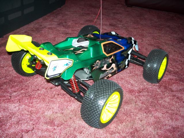

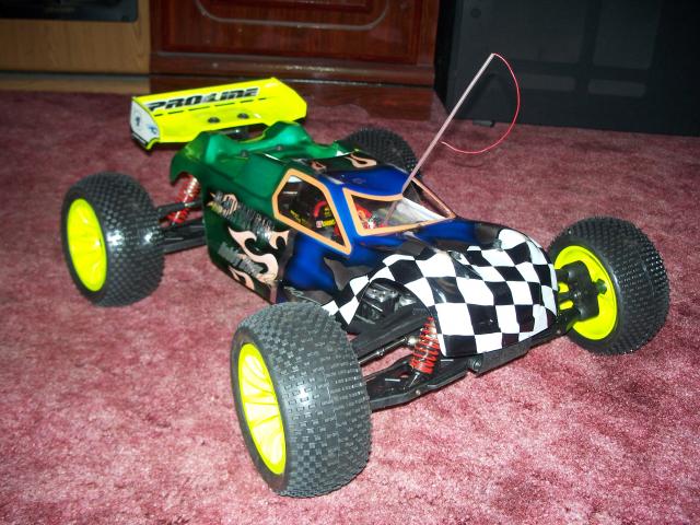

Running a nitro boby with cutouts in it.Only had time for 2 back to back runs today and both runs read pretty close to the same temp.Here's a couple pics.
