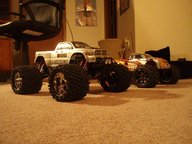

Well I am new to this site. I came from E-savage.com and wanted to come here and share what Im doing. I always use the name JEDI in forums so I call my truck the JEDI Savage. Anyway Here goes most of the build.
Here is the savage with FLM hybrid plates which use the E-Savage transmission with the GP front and rear ends. Integy msr8 shocks "wich are going to be changed out for LOSI lst ones. And for wheels and tires, IMEX jumbo maxx claw dogs wrapped around New era 40 series aluminum wheels.

And so it was born "JEDI mount". I fit it in my chassis and it was perfect. Plenty of room for the big castle neu 2200 "which is enormous" and had room for pinion adjustment. The trick with this mount is the motor is dead center in between the TVP's so I can still use the inboard E-Savage mounts. Which IMO look way better then battery boxes hanging off the sides. And it seems to be perfectly balanced because everything is symmetrical.

Here is a close up so you can see the ESC and motor. Notice I also added a 40mm fan that mounted perfectly to the esc tray that blows directly down on the motor.
JEDI
03.06.2009, 05:11 AM
And here I added XL axles to add a little width and the dog bones are alot better.
So now I am waiting on the CEN diffs to arrive. When I put in the diffs with 14t pinion and 47t spur the complete gear ratio is 16.9 which is very close to the flux. Also waiting on the LST shocks. When I get it all together I will add final pics. Any comments or questions are welcome. :)
