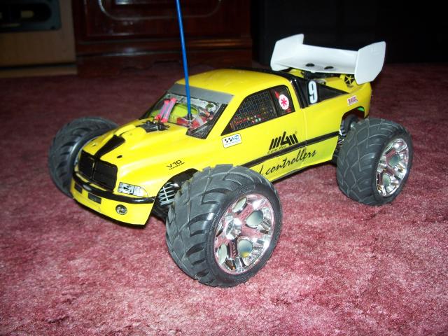

I used a proline desert rat made for a rusty;
<a href=http://i87.photobucket.com/albums/k137/darrajsam/bottomline.jpg target=_blank>http://i87.photobucket.com/albums/k1...bottomline.jpg</a>
I used a "bottom" line.

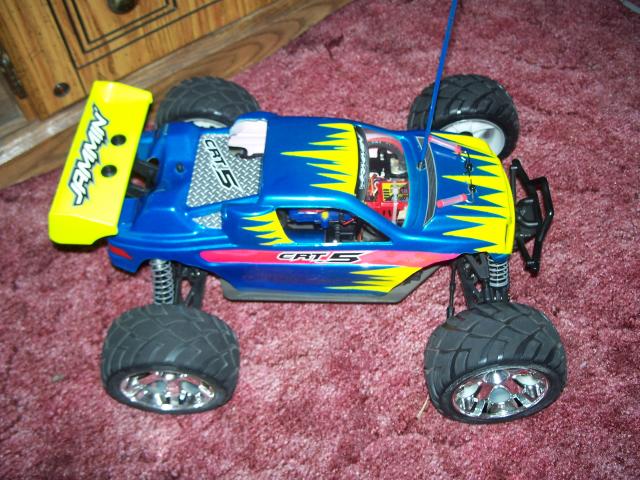

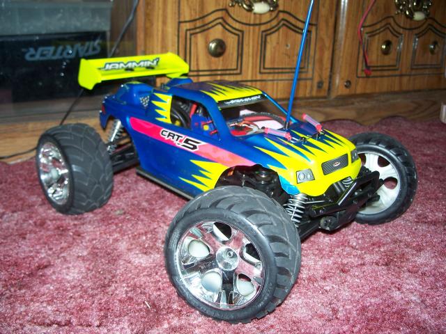

Most 10th scale bodies will fit with a little trimming here and there,now you are as long as a 10th scale and you have a world of bodies to choose from. Here's mine on the ofna xtended ,stock body.

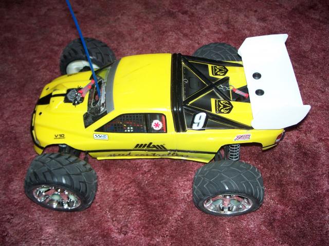

Here's an old hpi MT 10th scale body I use for street bashing.Seems to fit perfectly,maybe I will buy a new one and cut it out to fit better,since this was just a hack job to test,but wound up being a good fit.
