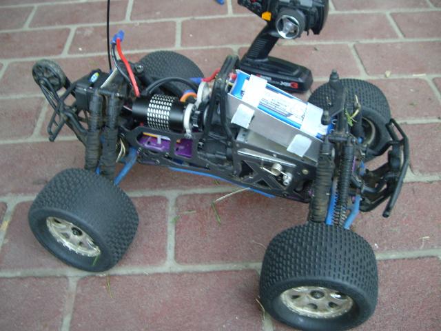

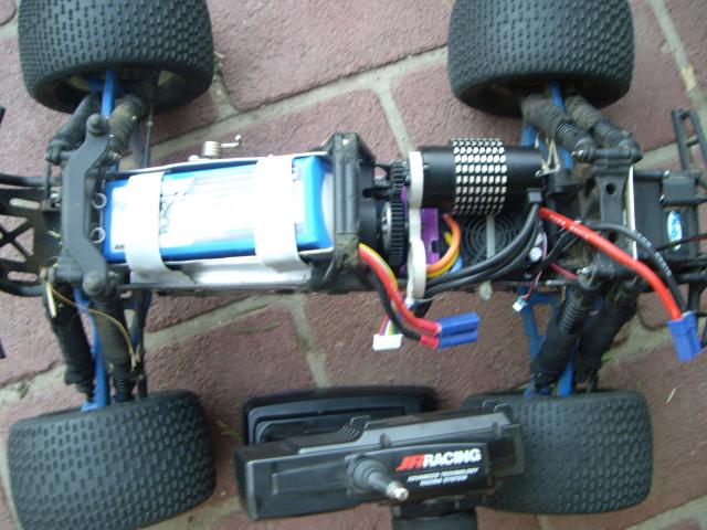

Here are a few pics of the car,will continue mucking around with the calibration when i get my new lipo,this time i will get a flight max 25c 5000mah,turnigy's are out of stock + i dont trust them anymore...
