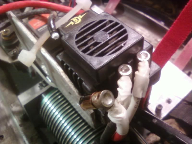

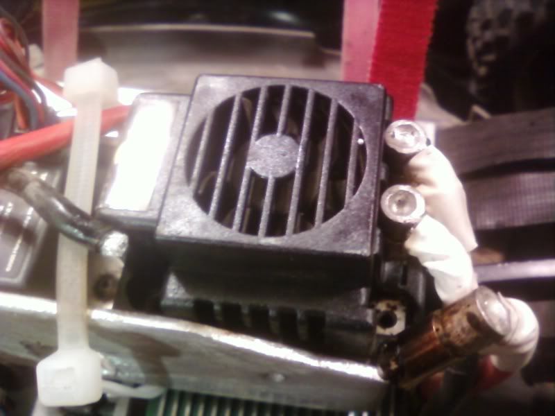

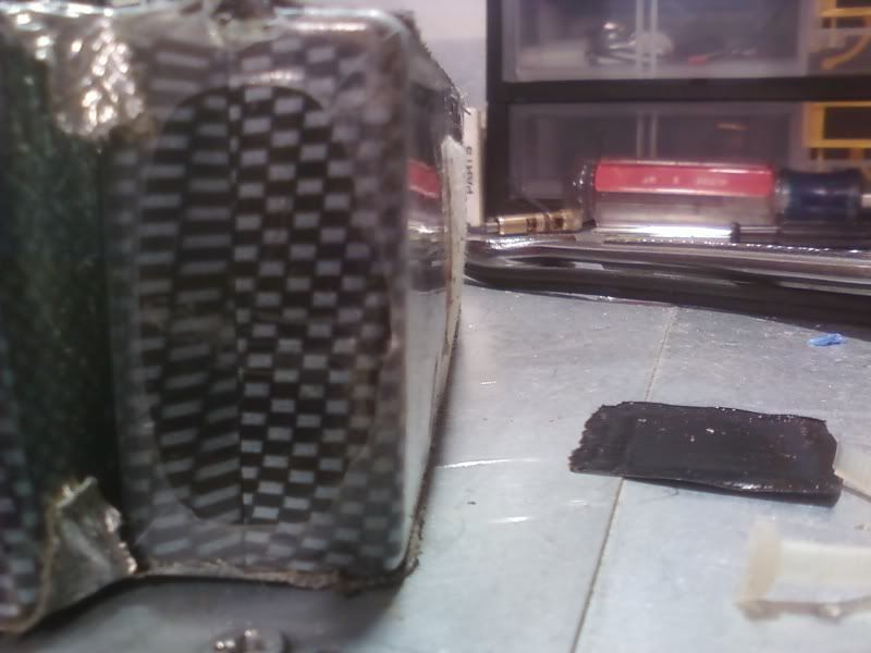

By the time i reach my hyper(~200 ft away)the smoke and fire had stopped. I ripped the body off and saw nothing but horror. I went to disconnect the batteries, and thats when I saw that my RC-M lipos were puffed. Upon further inspection, one of the 6.5mm bullets was de-soldered from the MMM, as well as the negative battery input wire. they were both extremely hot.

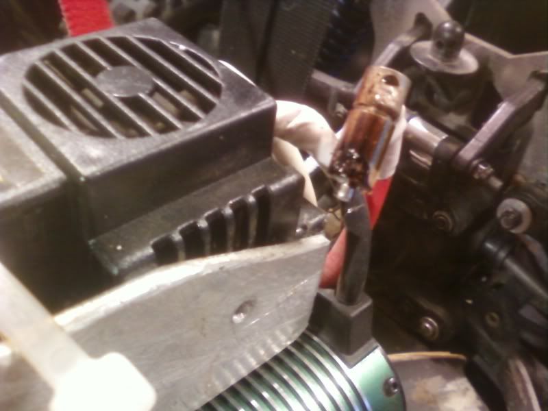

After looking at the carnage and discussing it with ben(brushlessboy16) I think I have an idea of what happened... It seemed that the MMM overheated to the point where the one bullet became desoldered. Since there were only 2 phases operating the rotor would bounce between the 2 phases. Since the rotor wasn't spinning, the MMM was pulling more and more current to try and make the rotor spin, causing it to overheat eve more and catch fire and smoke. The extra amperage being pulled was then too much for the batteries. It would've finally stopped when enough current was being pulled from the batteries that the negative wire desoldered from the MMM as well.
Some other bits of info that might help in diagnosing this problem is that the drivetrain was completely free, so there was nothing mechanically holding anything back (if there even is anything that could), and the negative bullet was melted into the female bullet of the battery. What I still dont understand is why it would intermittently stop, and then work when i restarted my Tx, and what originally caused the MMM to heat up to the point where the bullet was desoldered...
Any help or support would be greatly appreciated

I don't know if anyone noticed the black shorted spot on the connector. Well, that's the part of my connector that is touching the heat sink. Patrick will see this, but I'm still thinking the connector touching the heat sink might be causing some problems. I still haven't used my MMM due to all the connectors touching the heat sink.
