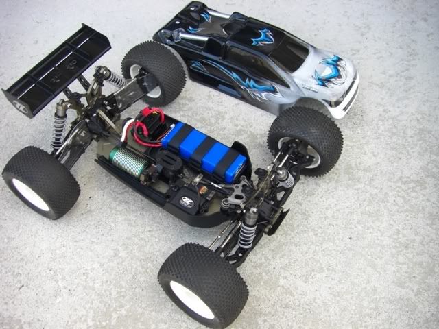

After a few weeks or so, I managed to get everything I needed to get her running and have had a few good runs so far. My wife took me down to the park yesterday to give my addiction a flutter, I do love this plug and play of racing around, no trying to pull a nitro into life with a bad back
I was running a 45t spur and 14t pinion with Zippy-H 4000mah, 5s - 25C and I was at 145-150 on the ESC (fan didn't come on though), 135 on the Motor and 105 on the lipo, ambient temps at 75-80, I thought that was a little on the high side than what I would of liked. This was after about 10mins doing a lot of hard take-offs and trying to get to WOT in the field of about 100 meters or so, it may be the temps are right for what I was doing, but I was hoping for lower . I will wait till my 4s pack arrives tomorrow and then give that ago, it's a much better pack (Hyperion 4s, 5000mah 25C) so will see if the temps drop in the ESC and Motor to a more cooler setting that I will like after 10 mins of running with a better lipo, I know it's gonna be slower, but man, it will still be stupid fast compared to my old Traxxas 3.3 rig

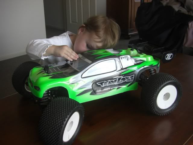

My body arrived from an eBay member in the States, thanks jayjay283 for showing us your link, I hope you don't mind us copying your stlye I think it's awesome, so does my daughter who could'nt keep her hands off it and trying to work out what's inside the "car" as she calls it
Anyways heres a few pics to show you the new body and how she sat in the weekend....................

Way to go Josh. Nice truck. The first pic with your daughter is priceless.
