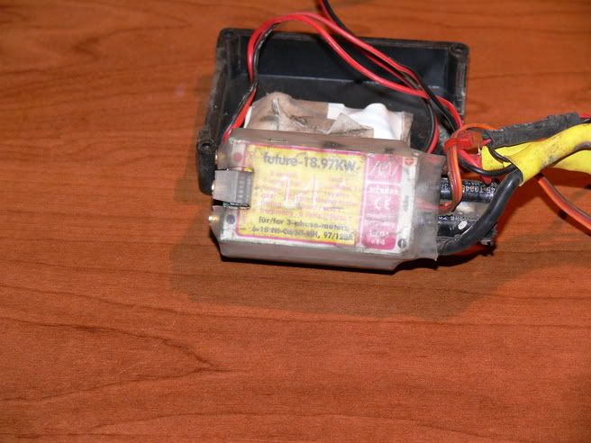

I was stripping down the E Maxx after a good session the other day and found this.........witch alarmed me some what :eek:
Am I about to become a member of Serum's expensive club???

Looks like all you need is a cooling fan or you might be a member soon.

Its dead Jim. Mine looked like that just before it went poof.

looks like you fried some of the fets.... what motor are you running with that?

A 7XL squee, Its never felt too hot after a run, and it always has a 40mm fan on top and on 18 cells it sure does shift the air.
any ideas as to whats caused it , as it still works at the moment maybe its not too late.

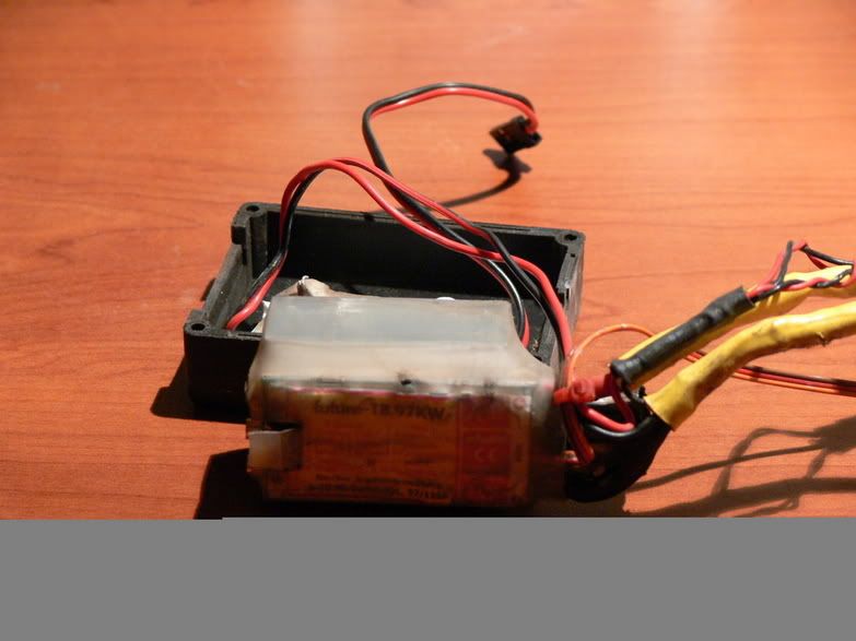

yup I've got one, you can see it in the second pic.

A 7XL is way to HOT for 18 cells. Try a 9 or 10XL. With the right gearing the slower turn motors will be just as fast(if not faster),have longer run time, and not beat your speed control to death.

The 7XL is quite a hot motor indeed.. Rhylsader burned his 18.97 on 16 cells with this motor.. though a few members on this board use the 7XL on a 9918/9920 who are doing okay..
