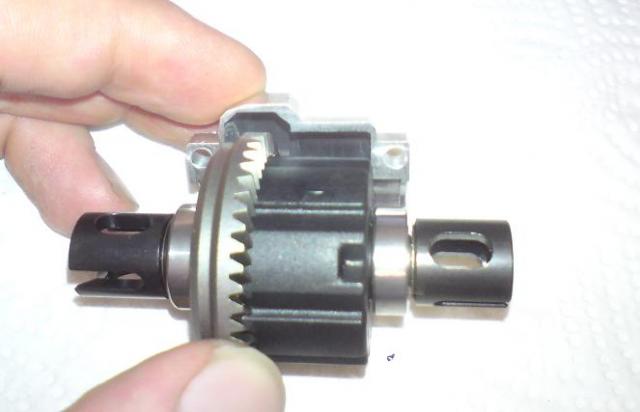

Ok here is a pic
the V3 diffcase is 23mm inner length !
but my x2crt diffs are 23,5mm long
so here's the question:
how long the rcmoster diffs are?
and
which other will fit into the V3 diff case?

04.11.2009, 02:36 PM
Mugen, Associated and Losi diffs will fit. I do believe Mugen diffs are supplied if you buy the complete kit

04.11.2009, 02:59 PM
thanks, magman that will help a lot
