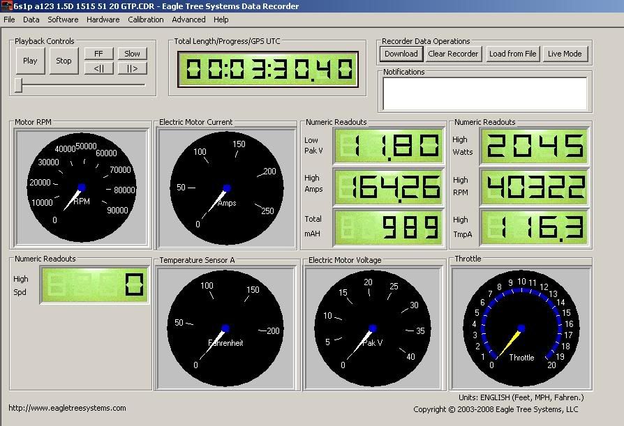

Bought RCHippie GTP, who btw is a great guy to deal with. I got to say that he dialed in the car perfect. Doesn't even looked like it was used much either. Anyways, I started with 1512 2y with 51/20 on 6s A123. I had to set the brakes on 20% on the Losi 1/8 esc. Car tracked straight like an arrow. Turned around and dropped in 1515 1.5D with same gearing. The power is insane. I break the tires loose and batteries warm up pretty quick. I'll use this setup in the Bracket dragrace soon. It's gonna be fun.

The losi ESC is still kicking butt and the GTP is a power hog. Battery temps were 125F, motor 106F and the ESC 116 after 3 minutes.
