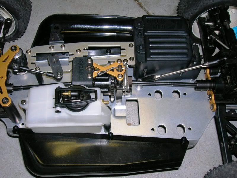

this is just a thread to show you guys what I'm dealing with in my first ever brushless conversion with a Kyosho MP7.5 buggy. it might be the kanai version, but i am not the original owner, so im not sure.
I scored this on ebay as a roller for around $150. i have never had a 1/8th buggy before and brushless is the only way i would get into the genre. Now is my chance.
the chassis has not on scratch on the bottom, but the tires are all about bald, so i guess the guy did some donuts on his driveway, put it on a shelf and sold it to me. its practically brand new.

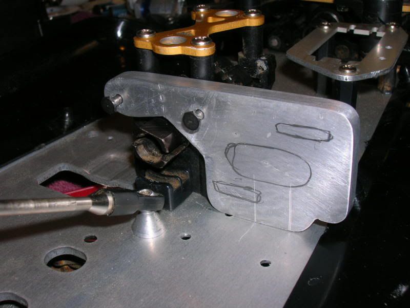

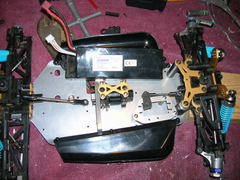

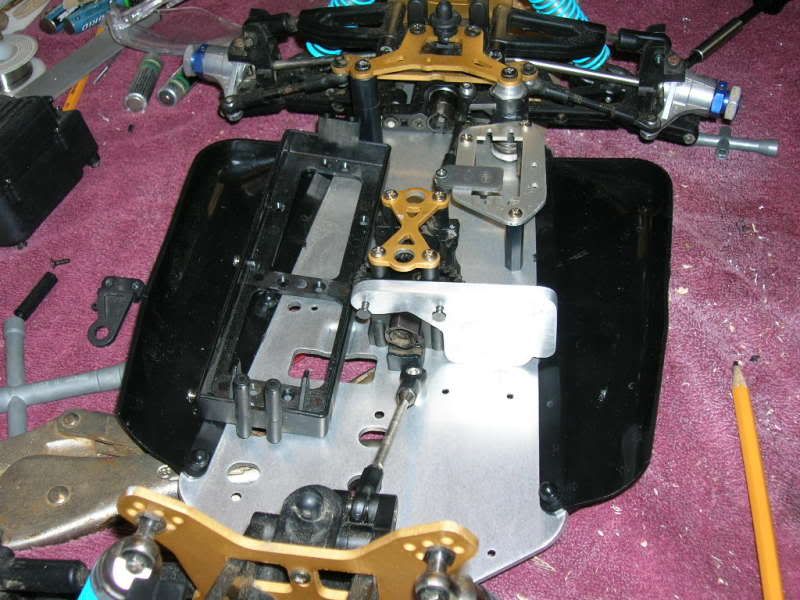

since these pics were taken i have started to mock up a motor mount, and also cut the servo tray to make room for the motor on the right side.
ugly body...
with the stock stuff in it...
with the chassis stripped of the nitro stuff and radio box.
pics of the mocked motor mount. (yes i know its on the wrong side)
i imagine this motor mount would work for a short time and the eventually break my diff mount because it is only mounted by where the Brake system was. i have some 1/4 inch alum to carve up with a hack saw and see what i can come up with. in the end i will probably get the mount that is made here. just wondering if the 777 motor mount fits the 7.5?

hey guys, here are som updates on the custom work so far.
ill post the link to the album in photobucket so you can see all the pics of the chassis.
i got the mount nice and sanded with some 400g around the edges and it clears the center diff cup now. i got kinda lucky with the measurements for this mount. the base is flush with the bottom of the chassis. this has allowed me to drill fromt he bottom of the chassis into the mount. i can tap the hole and reinforce the mount with a bolt directly to the chassis. i think this will greatly improve the strength of the whole mount.
i also cut the servo tray and rounded that off to make it look nice and neat.

Looking good, you definitely want to attach your mount to the chassis from the bottom (as you mentioned). The thickness of your mount is also good because 5052 aluminum is a little on the soft side, but 1/4 should be fine. Nice solution to those that don't have the equipment to machine the center diff bearing hole to make a one piece motor mount. Question, any reason why you have the motor mounting screw holes offset? Just curious.

Looking good- have you considered getting some shorter screws so that they sit flush to the motor mount?

i only have the mounting screws drawn offset. once i get a motor i will then be able to decide if it needs to be offset.
BL RVO:
they are just not in all the way. mock up only. they sit flush when tightened all the way.
in the coming weeks i will be able to get a better idea of what type of holes to put in the aluminum to lighten it up and maybe add some cooling fins, but i dont think cooling fins would be much better than just leaving it alone. almost just a gimick to put cooling fins on a motor mount.
