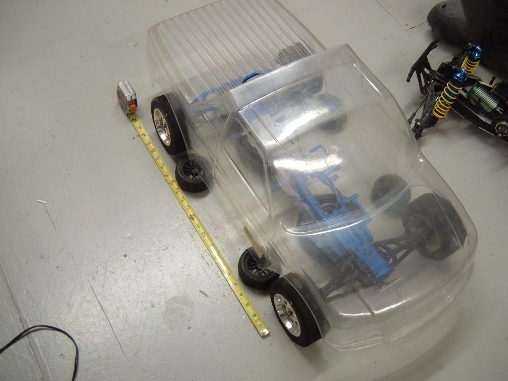

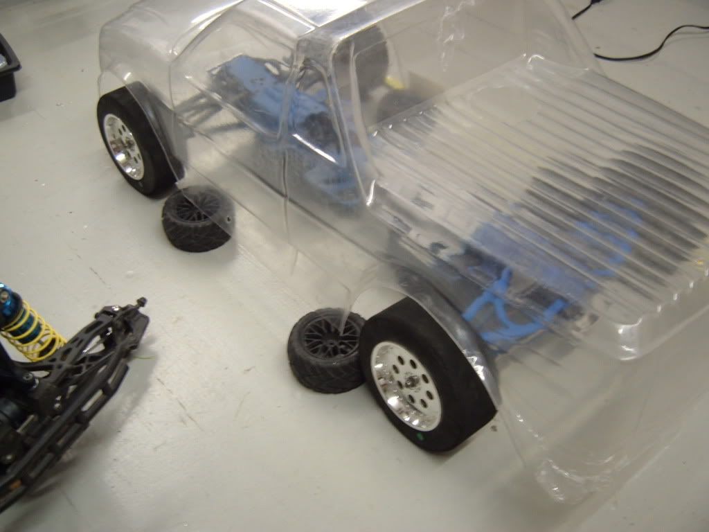

As the title says this is a bit weird.

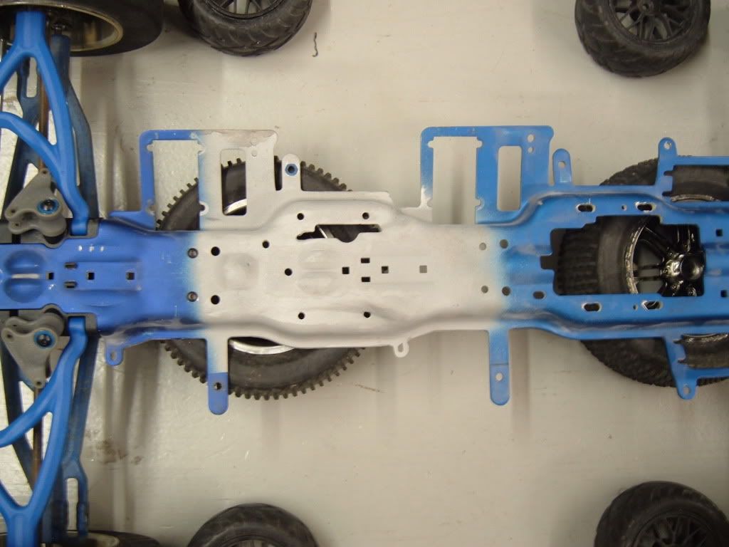

I took 2 revo chassis, a 2.5 and a 3.3, trimmed on up in front of the tranny area and had my buddy weld them up.

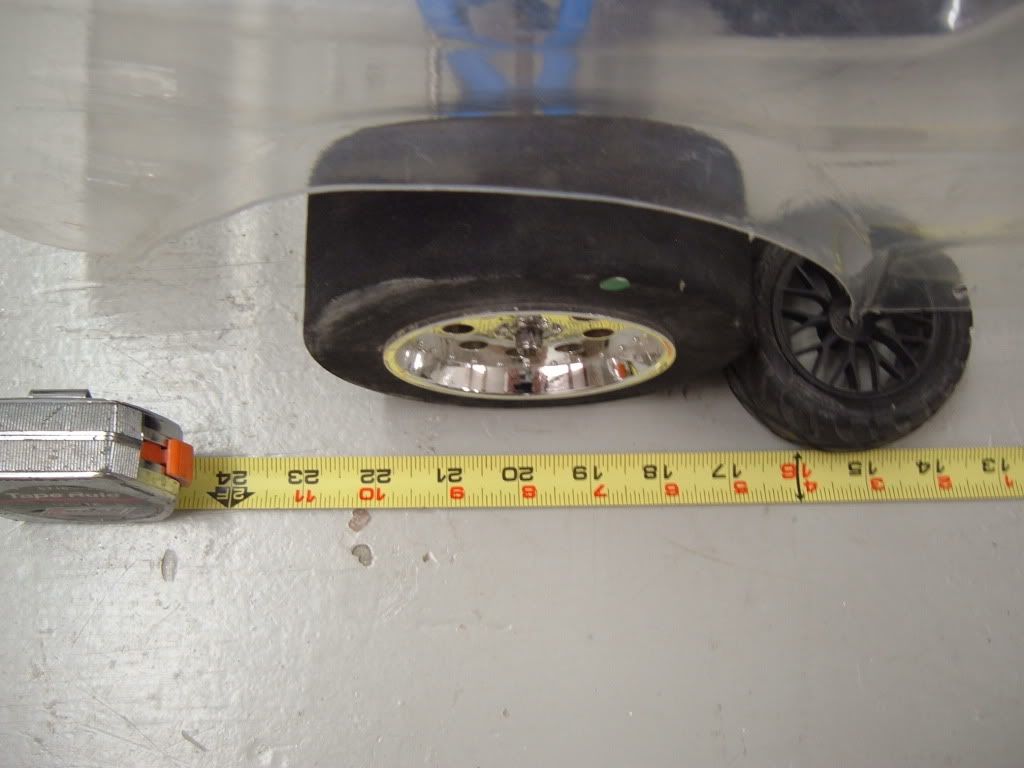

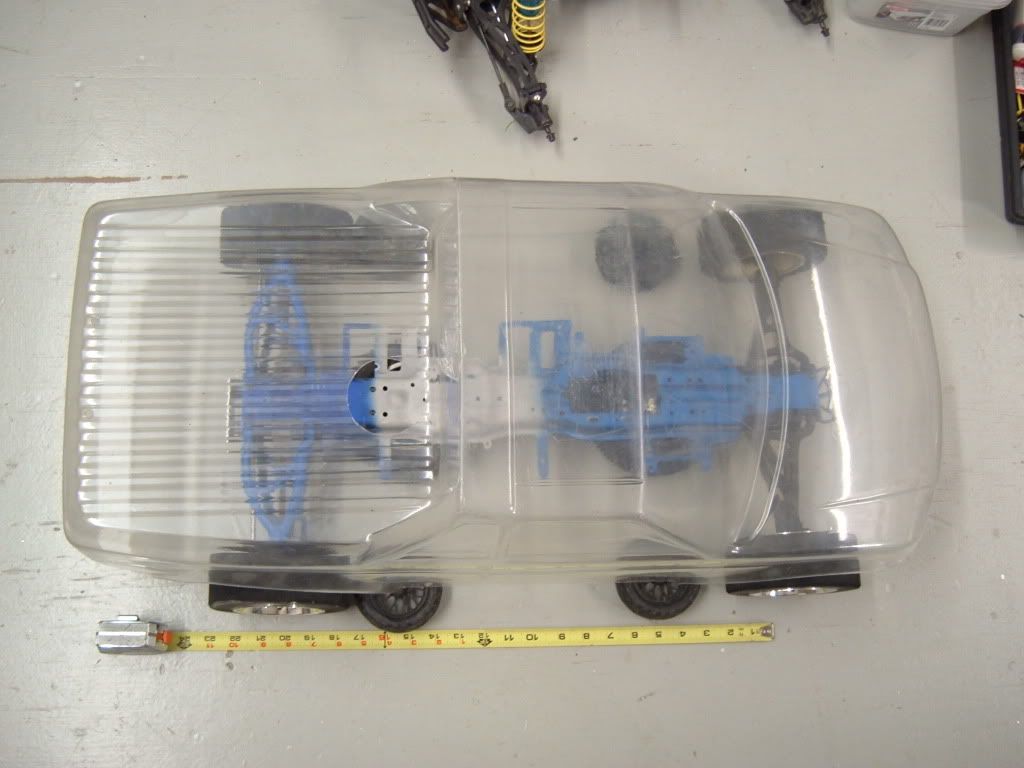

Wheelbase is about 20", stock revo track width. Not sure on the overall length or height of the body.
Not really sure what to power this beast with, maybe a MMM/2200 combo on 6s. I have a set of Mike's hybrid diff cups, and I will have rc alloys make me a rear driveshaft.
Not sure where the foams came from, think they are imex.
