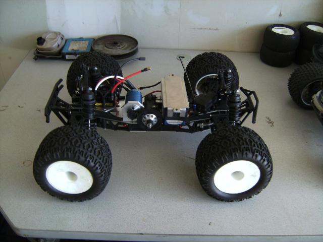

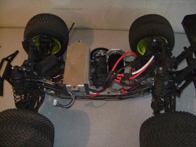

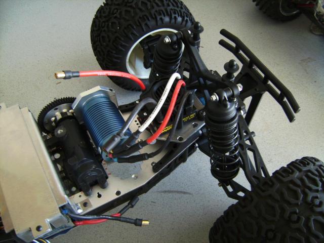

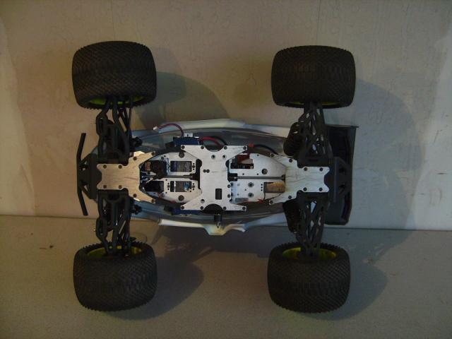

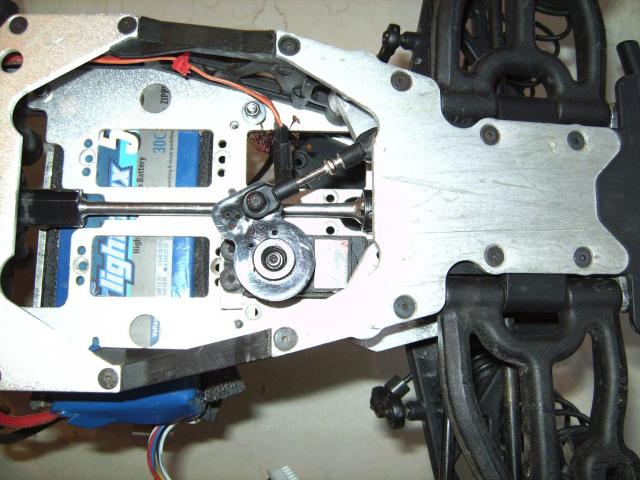

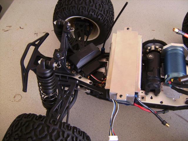

When are we going to get a LST area on the monster here?
I'm working on building my second brushless one and have some questions ideas.
I cant seem to find a good single servo conversion thread. I've been on lstforum.com with no luck. I have done one to my current lst2, but I'm not sure I'm getting the most out of it yet.

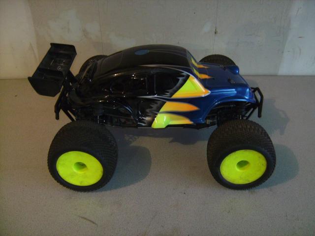

current pics of my lst2 setup
1515 2.5d
mmm v3
6s 30 c 5000 zippy flightmax
pinions, 25,23,20
spur, 59,63,64,66
swaybars
rc raven dual stage springs
XXL center diff gears installed (a touch faster then lst2)
flip mod inside tranny
TDR motor mount (modified), spur gear adapter
currently this is my 7 year old sons favorate truck to drive

doo540, that's a nice LST2 you have there! How are you liking the RC Raven springs and the swaybars? I had ravens on my orginal e-maxx 5 years ago and they were a big improvement over stock.

texassp
My truck came with those integy shocks, i tossed them and got a set of the lst2 shocks, everyone on lstforum says they are the best. With the sway bars and the muggy tires, I can corner pretty fast on the pavement, in other words the truck stays planted no matter how hard I throw it around. I also have my truck in the lowest ride height position. I broke my first knuckle this weekend, I hate adding aluminum parts, I will give the stockers one more chance and then onto aluminum. I did sell my e-revo and now I'm looking at having 2 lst's in the house. I know my lst handles better then my savage xl (bl) at high speed. So its on its way out also.
