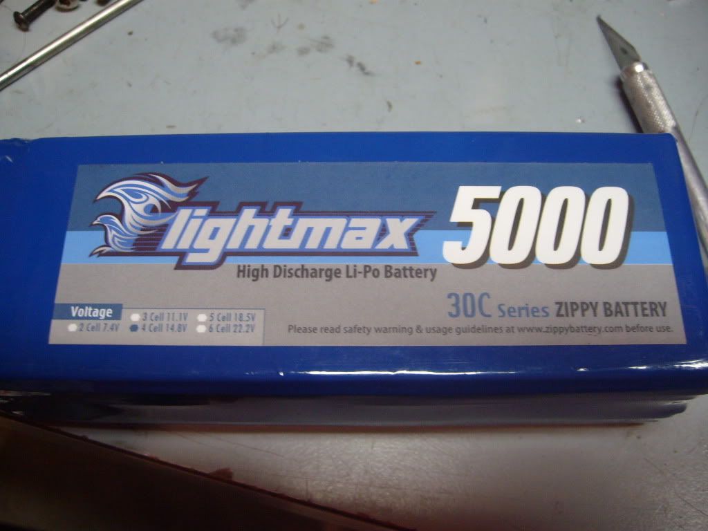

Well, I got an 8ight roller for $125 and traded it for an E-revo roller. I got a 30c 5000mah 4s zippy flightmax battery for $75. I got a used Medusa 36-60-2000 with a RCM heatsink/clamp for $70. I had a mamba max from my crt .5 that i got used for about $85. If you wanna be picky my new servo and battery tray cost about 20 bucks combined.
Grand total comes to about $375. Oh yeah.

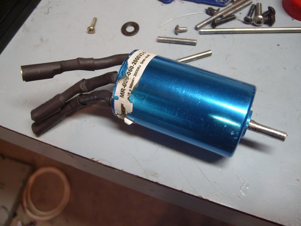

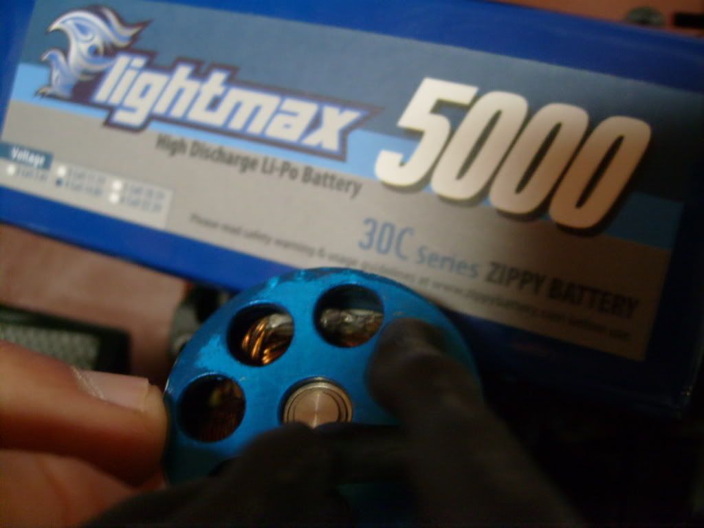

The Medusa has some soldering in it best seen in this pic. It doesn't seem to affect performance too much, so I'm not going to take any action now. I don't know who did it or why...

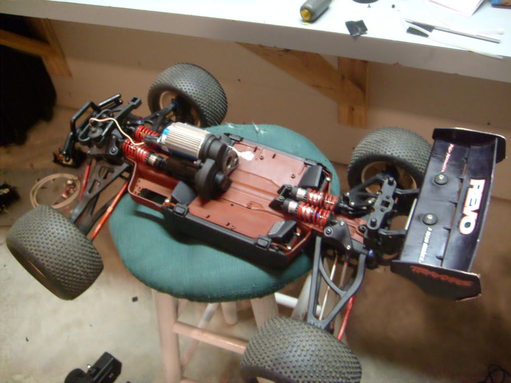

The revo roller came with cvds (a little bent), a tekno wing deal, dyed parts, red anodized rod things, a custom painted truck body with yellow flames (the body's a little too short), and 23mm crimefighters. I might downgrade on the axles so I can use my 17mm e-maxx wheels for bashing in loose stuff... Don't think I'll snap to many on 4s.

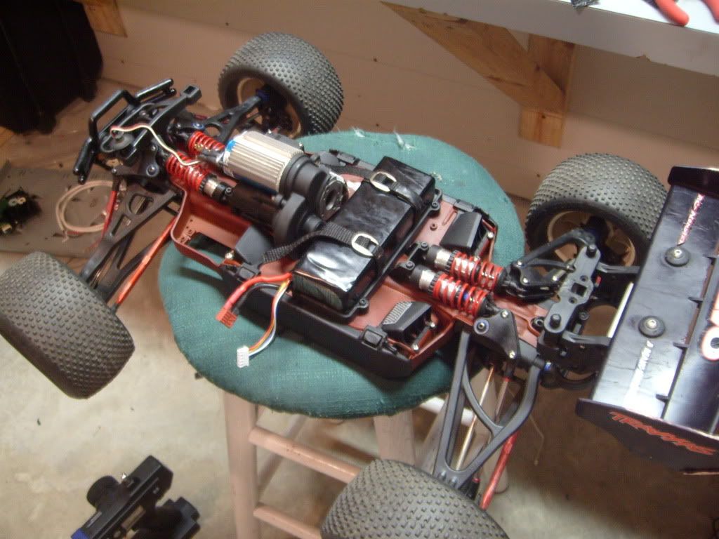

I got the battery and taped the cells together then re-shrunk it. It doesn't fit in the compartments. Instead of cutting up the nice chassis, I found a different solution using a Tekno v3 battery tray I stole from my crt .5.
Here it is as it sits now

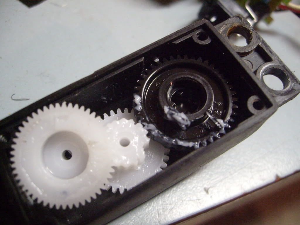

I haven't ran it real hard yet, but in light bashing the esc never topped 140 and the motor less then that w/o the heatsink. Haven't ran it with the new arrangement yet. Zipties held the battery on. A stripped crappy servo ended my run doing a cartwheel. I am going to replace it with my hxt 12kg servo (from my crt again) that has metal gears, but I still want to loosen up the servo saver. How do I do that?

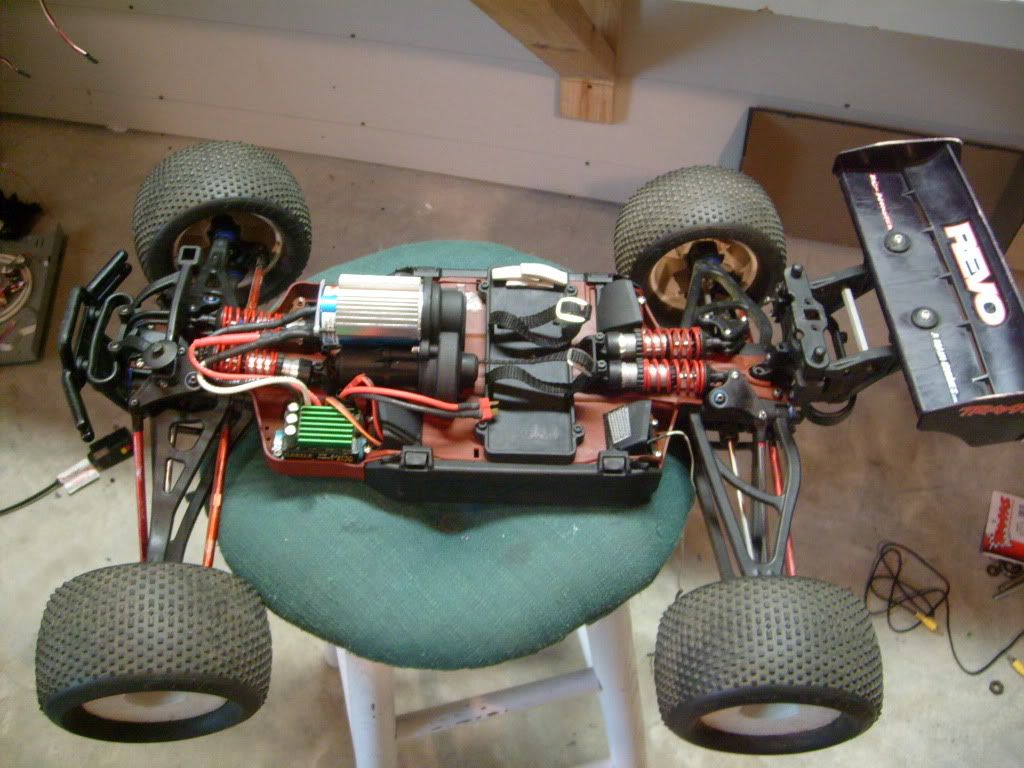

Got some running in today. Front diff is still shot so only rwd for now. Speeds were estimated in the lower thirtys. Temps for the motor and esc were both about 120. I'm going to put some thermal grease on the motor between the heatsink and get a fan for my mamba max, so I may be able to gear up. The front diff working might heat things up though, so I'll wait and see what it does.
I had several battery ejections due to crappy straps. I'm working on fixing it. Some of the ejections were on cement, but I put another layer of heat shrink on it and there's no visual damage.
I also experienced quite a bit of "cogging", but I think that was because my batteries were low in my radio. I'm under 10v now.
One problem I may have - My rear diff is "loose". Everything is installed as it should be but if I wiggle the outdrives the diff moves with them. Should I be concerned?

Oh, on the soldering inside the motor you were looking at, the factory did it. That's a wye wind termination. They all have it.

I've got a bec, and THANKS for the info about the soldering. Man that had me paranoid.... Next time I take the gear cover off I'll let you know. Should be soon cause I have to put heatsink compound on...

That Zippy battery you have is the exact same thing I ordered thinking that they might fit in the ERevo's battery compartments but they didn't so I split them into 2S packs. They now fit and they are very good packs. You might want to think about splitting that pack so you can put the batts in the compartments.

I looked at the novak fan. It says it pouts out 2.8cfm. All the other fans seem to put out 1.2cfm. Should I trust the ratings? Has anyone compared the two?
And MrCrash, I would love to slplit my zippy, but I don't have the tools or skills as of now. I don't want to send it to linc either because The pack only cost 75 bucks and I don't want to spend any more on it.
