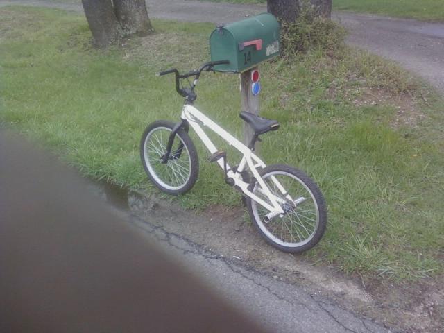

Well Here it is, starting the project off with a 20in Redline Bmx Bike.. All steel frame etc. Its a nice bike to begin with, steel frame and some decent wheels.
To power it I have one of these big ass brushed electric motors that i have laying around- and a 16:1 gear reduction box. Also picked up some 35 chain and sprokets for drive... BrianG- your gearing calculator is a life saver.. have it spec'd out at 22mph on 6s lipo. with low gearing and lots of reduction it should keep amp draw relatively low.
Just a project to get me from point A to point B being as lazy as possible.
Planning on making a steel subframe/ motor mount and weld it to the existing frame.
Pictures will be up later today.

Here is the bike..
Is there any way to directly control a speed controller with something like a potentiometer?
I can get a twist grip for an electric scooter if there is any way make it work.
if not, does anyone have or know how to make a cheap servo tester?

Thanks luciano, but i have no problems with steel, it will be built with braces etc to stop from bending..
You can use a servo tester for controlling the speed controller if you have an rc type controller.
I know I can, but twist grip would be pretty neat
I was in Academy Sports this past Saturday and stumbled upon the battery powered bicycles for him and her. They use a brushed motor like the electrics scooters do. They just basically adapted the scooter setup onto a bicycle.
Yea, but the speed controllers they use are not as efficient or powerful as any Rc controllers. Im probably gonna use my MMM for the moment in this one.
Metalman had a link to a twist grip control that would run a rc type esc. Can't remember where he had it though.
A searchin' I will go.
THanks for the info guys.
Now, since i want to retain the stock pedal system- would i be able to set a slight drag brake on the MMM and use the regenerative abilities of the speed control to recharge the batteries? I dont know how much power the regen braking actually saves..
