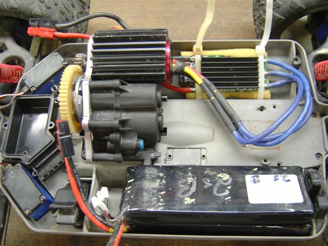

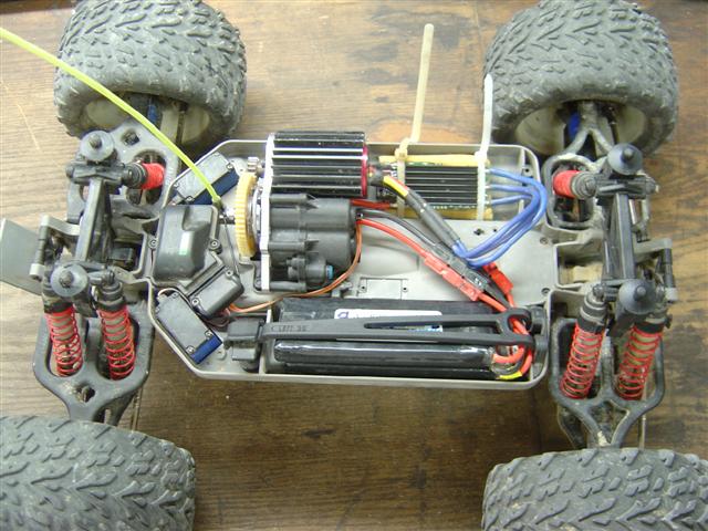

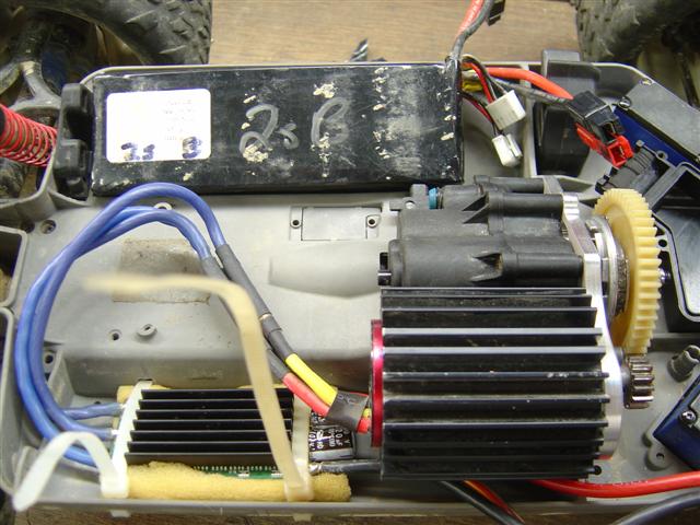

I have e-maxx with small BL motor and BK 7020 control with 4S batts (kinda mild set-up)
Here's what it does wrong. I'm not sure if it's a radio problem or controller.
Only when over 100ft away AND letting off throttle it is jittery or no-throttle until it gets closer OR I go back to neutral.
When running at close range it does everything right (even at WOT)
Wehn running WOT it does everything right (even at far range)
If it is over 100 ft away and you never let off the gas it's fine. If you do let off the gas it will be very jittery if the vehicle is allowed to stop, if the vehicle isn't allowed to stop there's steering perfect, but no throttle until stopped.
Is radio problem or control hitting some safety or cut-off?

I have eliminated the TX , RX and the trouble was in a different e-maxx before this with 12 cells and no seperate bec. Now I have a different 7720 and have run it with and without bec. It doesn't seem to act up on 2S like it does on 4S. $s also seems to be a bit worse than 12 NI cells were.
The only thing that is common between the two truck is the 2PL Futaba TX and the chinese motor 56x60x2200 rpm. The other thing that's the same is the BK 7720 (even though it is a different one) They both do it.

I just hooked the packs in para rather than series and the problem completey goes away , it runs good even far away.
Next step is perhaps to use a smaller and/or lower KV motor with the 4S. I had planned on using 6S on this set-up , but haven't got that far yet.
hoober
Posts: 174
09.11.2008, 07:50 PM
Back to 4S with all twisted wires and if allowed to go jittery at far distance I can keep it held at WOT with no motor movement at all (just steering)
Only when releasing throttle to Neutral will it start again. Seems like a LVC somewhat. I don't think it has one though? Definately the higher voltage is worse.
