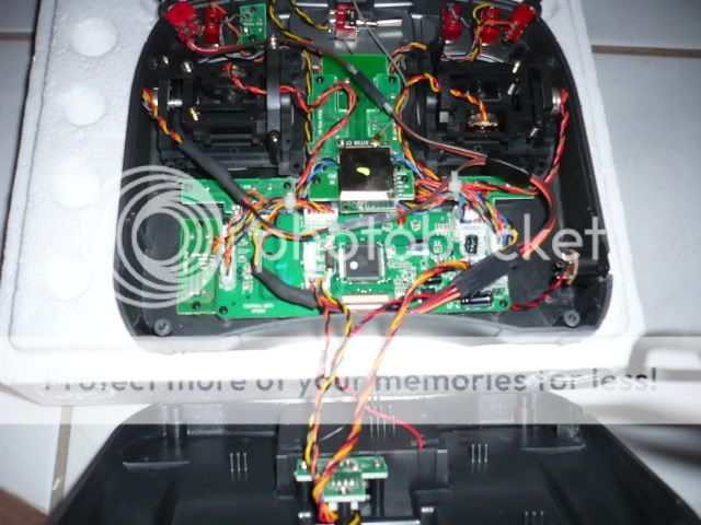

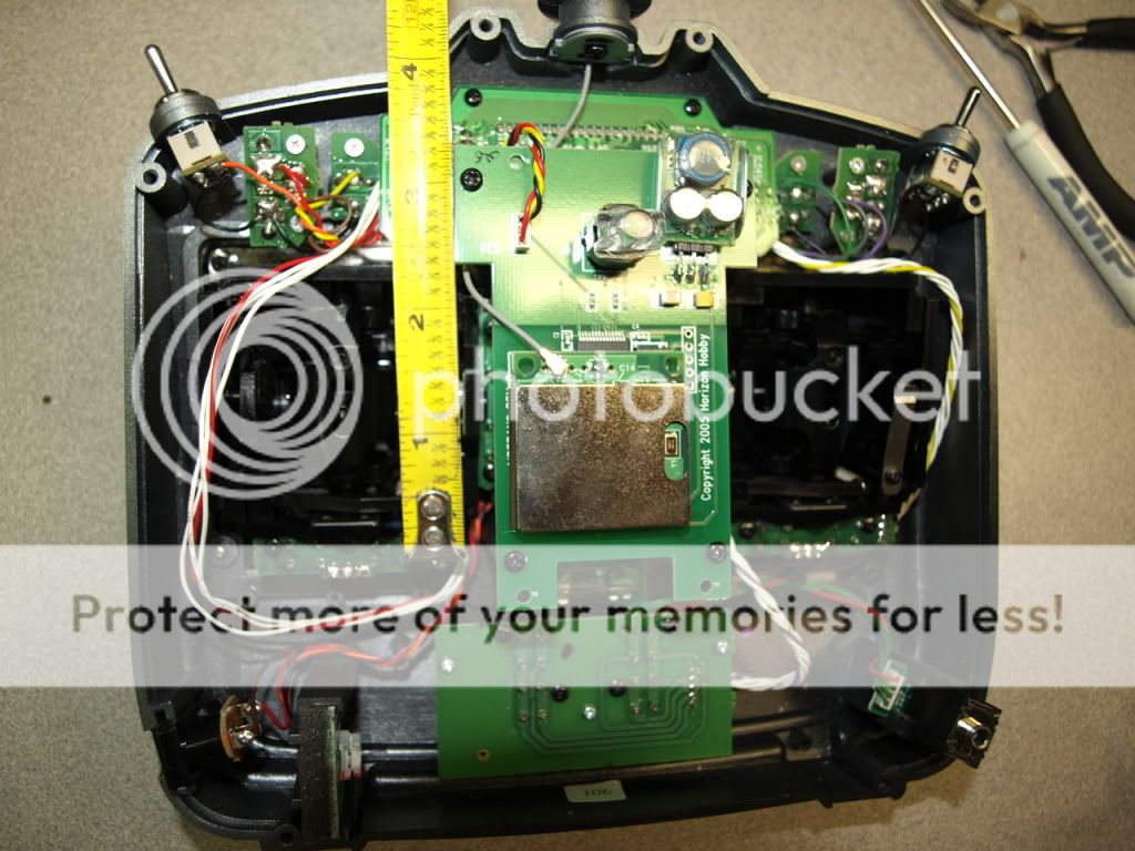

The DX6i has smaller electronics boards than the older DX6 and just uses 4 AA batteries, the Dx6 uses a rechargeable pack.
This puts this build into a tough challenge because the LCD PCB board is 4" tall and cannot fit into a standard Pistol style Radio. So if you already have a DX6i you should not need additional project box's to fit the components
I think I will use a DX6i instead

The 6i does look easier to mod... I have a dx6 somewhere I may take the back off and get a better look. Sounds like a fun project. You can pick up the 6i transmitter for about 115-125 new on rcgroups, and maybe a little less used.
