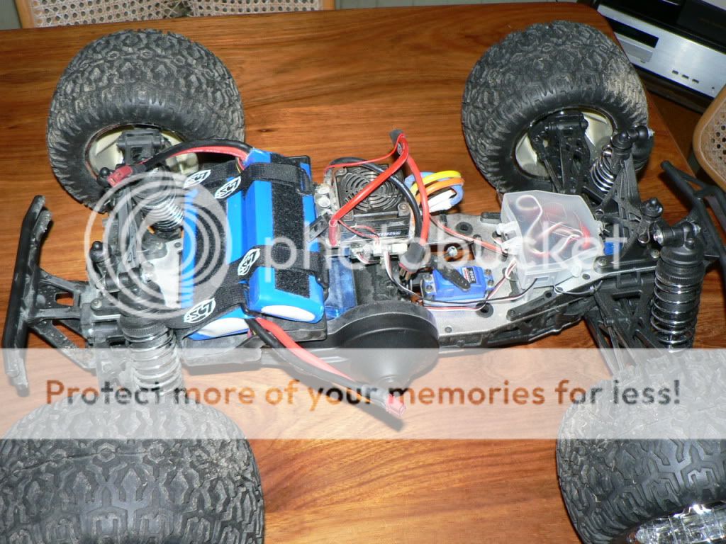

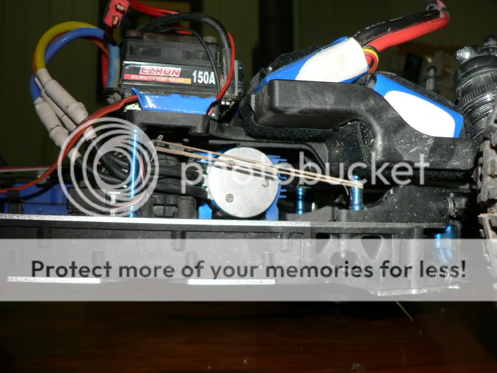

1st Stage
Motor: Losi 1300kv
ESC: EZ-Run 150a
Servos: Dual Ace 1015's

01.12.2011, 04:58 PM

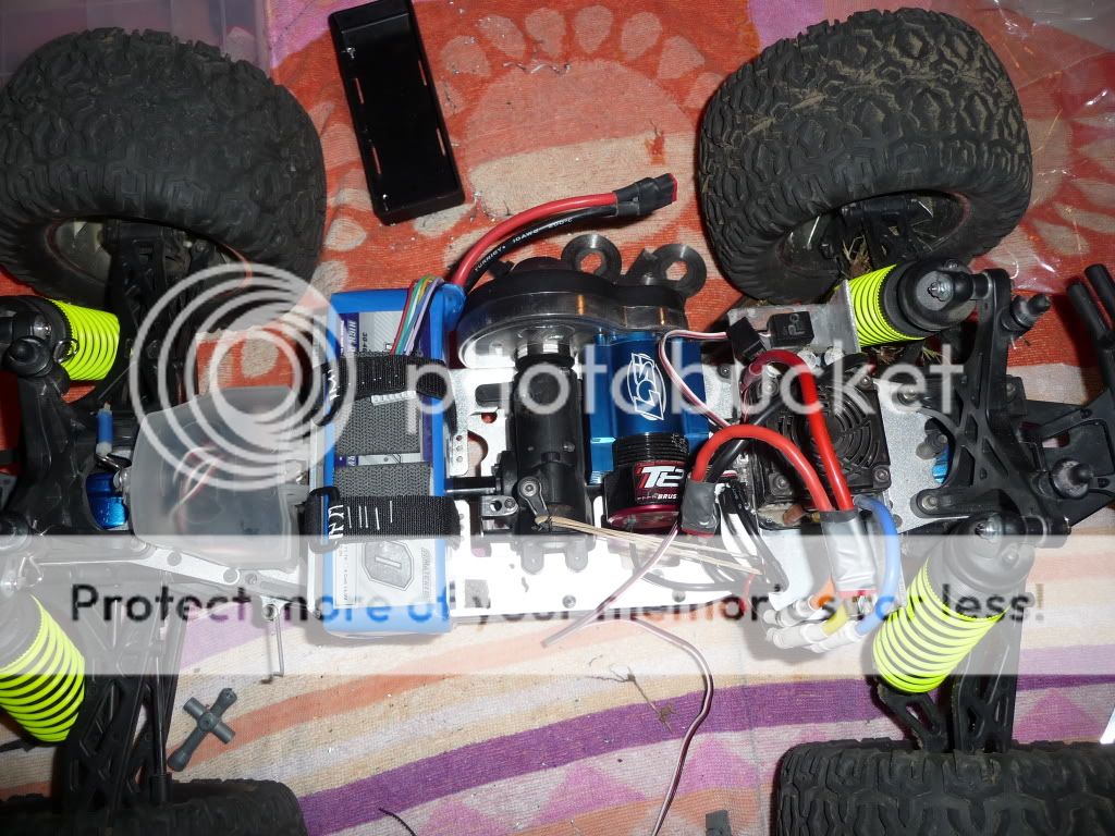

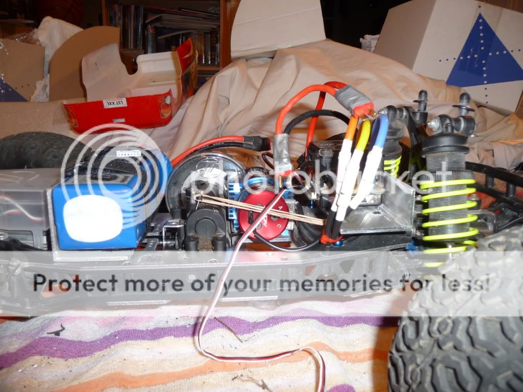

Stage 2
Custom battery tray
Still using Mech brakes
Motor: Tekin T8 1350kv

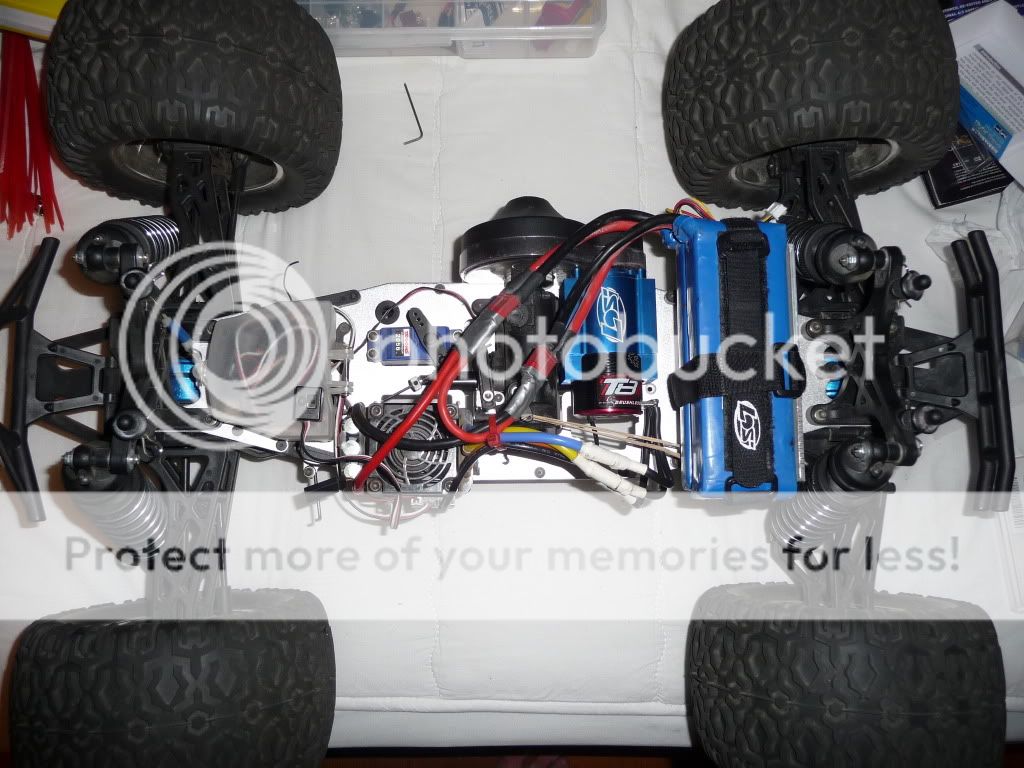

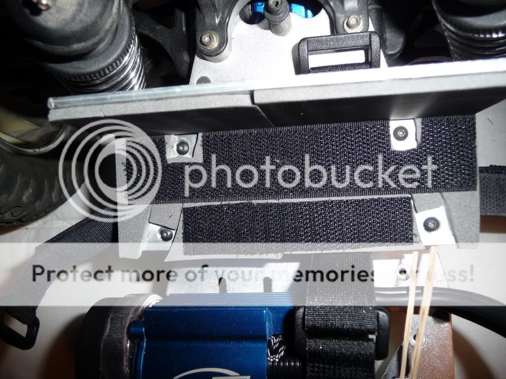

01.12.2011, 05:00 PM

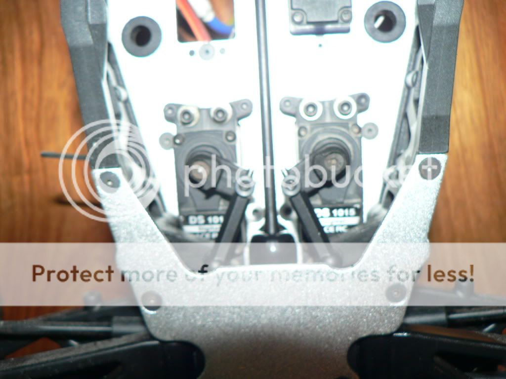

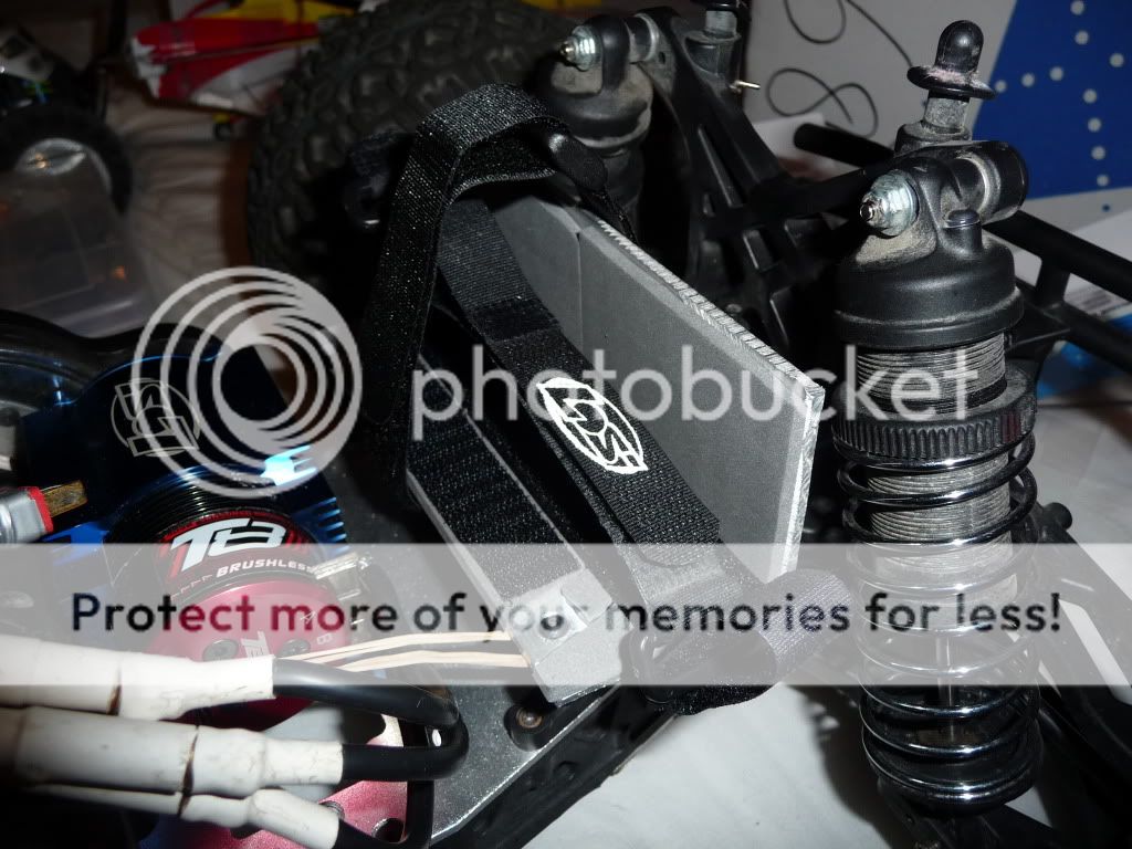

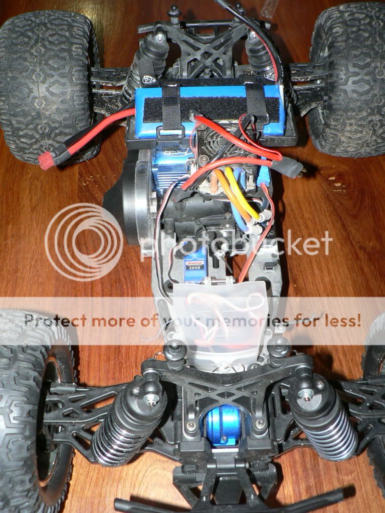

Stage 3
Battery moved to between Tranny and RX/Steering servo
If these pics are too big let me know and i'll change them.

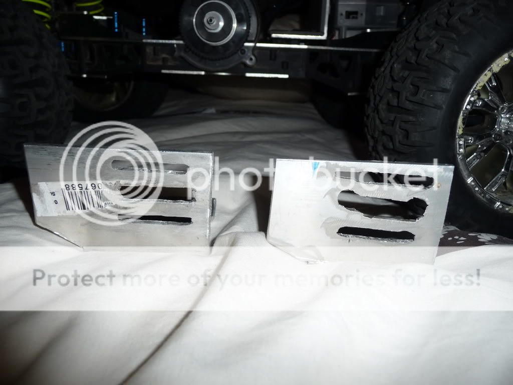

01.12.2011, 05:01 PM

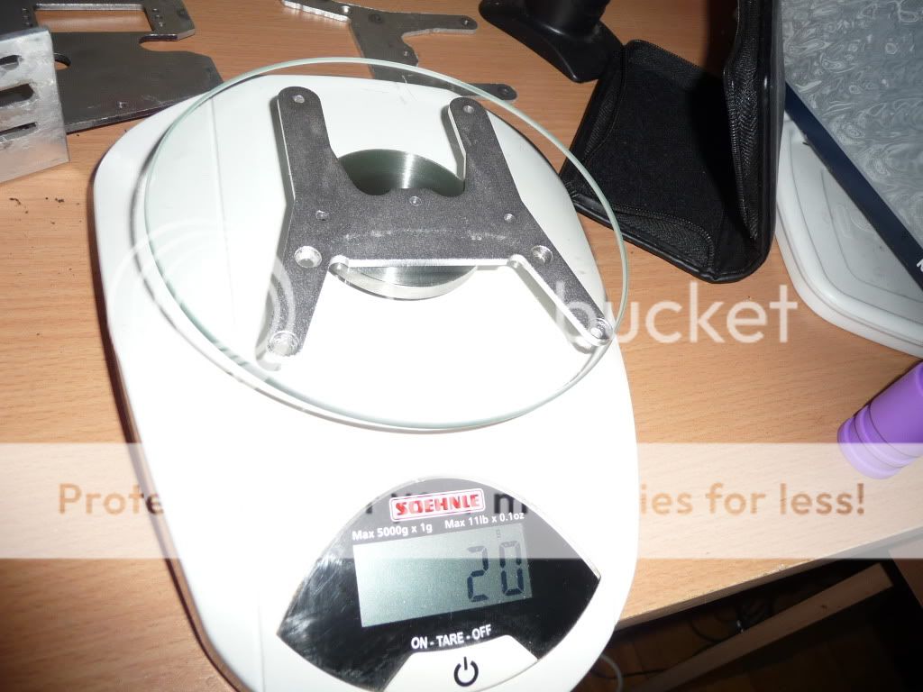

My custom motor mount
1st attempt - Right side
2nd attempt - left side

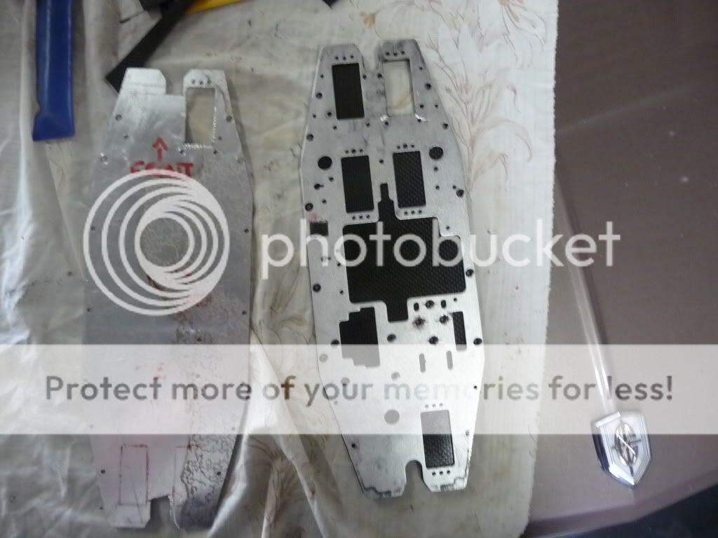

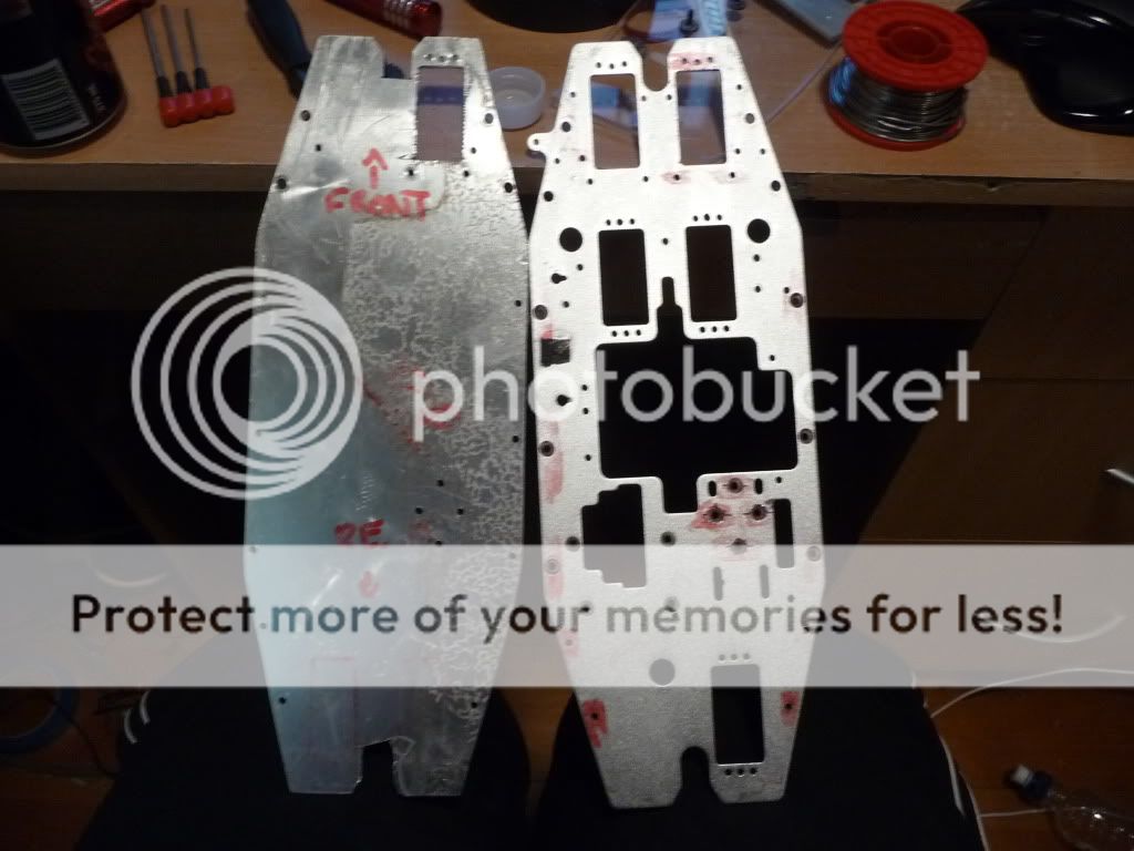

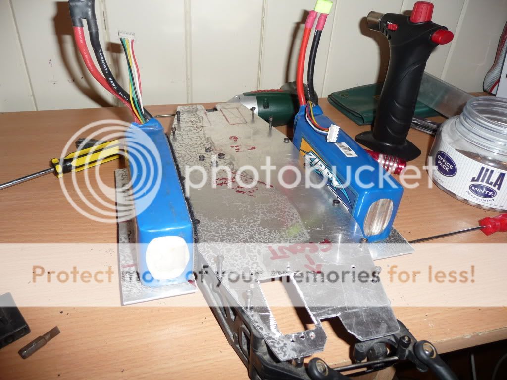

01.12.2011, 05:09 PM

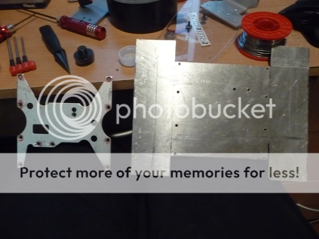

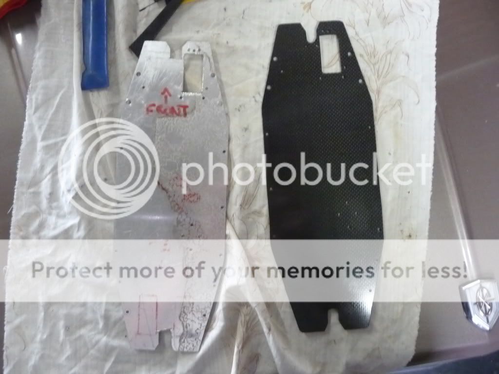

The start of the mock-up chassis
The batteries pictured are 4s 5000mah lipo's
more inspiration http://www.rc-monster.com/forum/show...=25581&page=15

All of the stuff pictured above will be redone with CF. 2.5mm thick. The stock chassis is very weak and i would say not even tempered so i think the side rails are the backbone to the kit and give it most of it's strength.
I havent ordered the alu yet as i might change my mind and get the 1/10' stuff as it's roughly the same thickness as the stock chassis.
For the alu though i am sorta thinking of doing the lower centre plate with that or do a brace for the CF with that. This project is going to take a while and most of that will be waiting and thinking about how to do stuff.

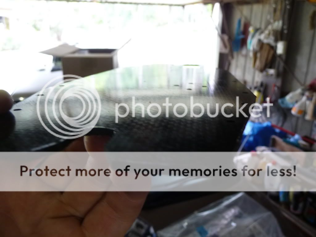

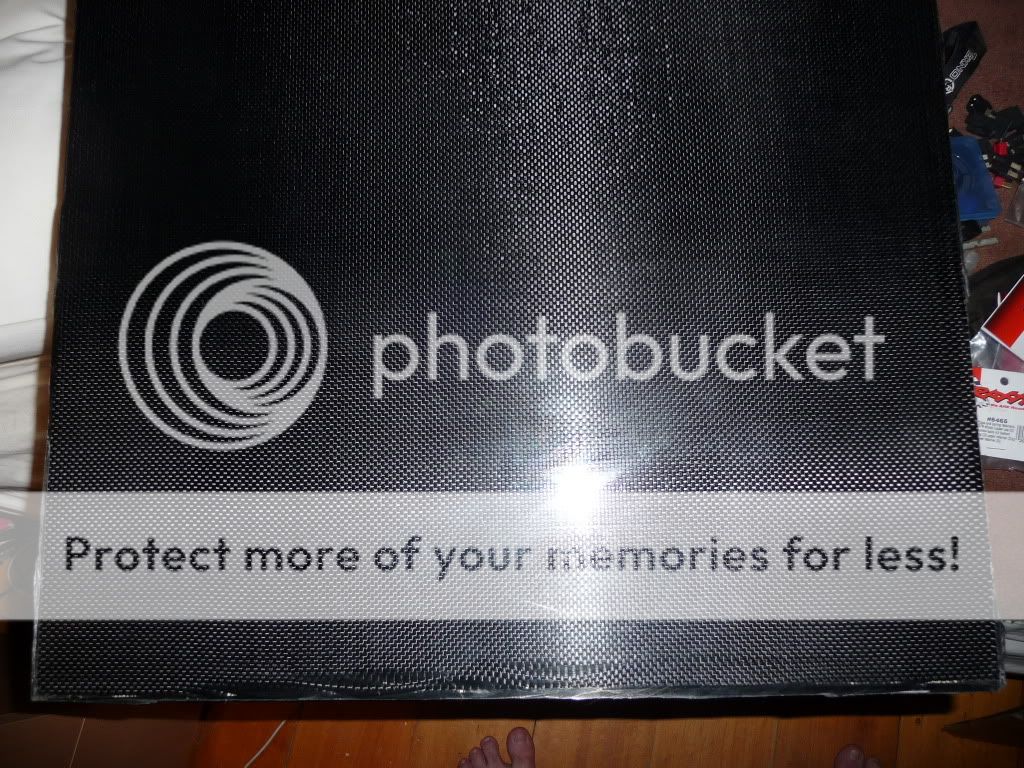

01.12.2011, 05:12 PM

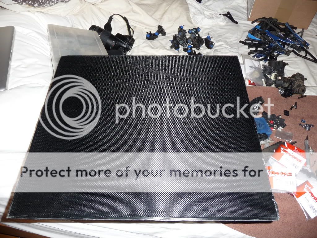

Got my cf sheet in 2.5mm 450mm x 500mm
here are some pics.
have a look at the lower part of the sheet in the 2nd pic. I'm a little unhappy with the finishing job on the edges and how the weave goes crazy towards to bottom.

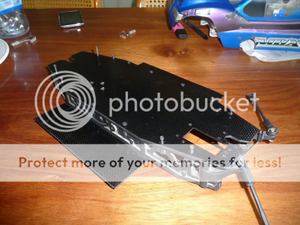

01.12.2011, 05:13 PM
pics

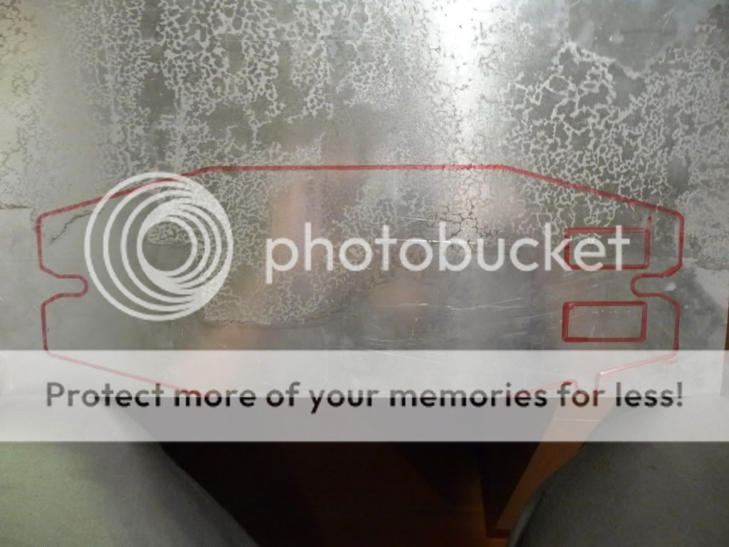

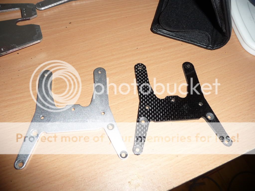

Today i cut some more bits out of CF. I did these by using my dremel router table attachment. It hakes it much easier to cut things that have weird shapes.
PICs
