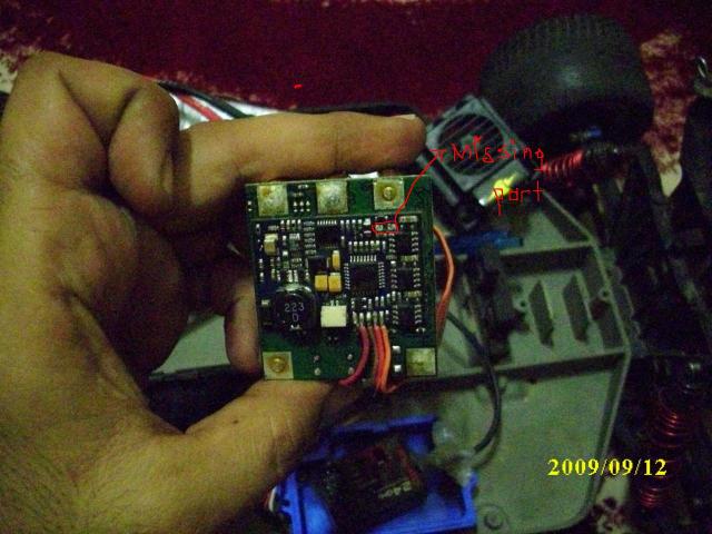

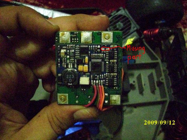

alport
09.12.2009, 09:32 AM
HI again
I found the problem. I opened up the esc and saw that a little electronic part brake off. I can't find the missing part. Now I need your help to repair it by myself. I don't want to send the esc to Castle to repair because I live in Turkey and that will cost me much time and money. On the attached pictures you can see the missing part. Can anyone take a picture like that of his working esc. I'll look the local electronical shops to find this missing part.It's very easy to open the box of esc here is a description.http://www.castlecreations.com/suppo...nster_case.pdf
Your help will be much appreciated.

09.12.2009, 12:00 PM
I kinda doubt you'll find the part you need in your local electronics shop, and its even harder to make a good soldering job on the esc as Castle use special high temperature solder- more likely to damage the esc and surrounding components through the heat.
As it is, there are a few good pictures around this section-
2244
T35HV
hard to make out, but thats what you're looking for, its in the bottom left of that picture, upside down. Maybe Castle can send you the missing bit, or you may be lucky and find it online, but I think you may end up having to spend the money to send it in and get it repaired...

emaxxnitro
emaxxnitro's Avatar
Posts: 491
Location: Kerrville Tx.
09.12.2009, 01:20 PM
it falling off may have fried something else, best send it in

09.16.2009, 01:47 AM
alport, your missing part was a tantalum capacitor for the internal 12V generator, 22uF16V. Find one and solder it to the PCB, pay attention to its polarity when soldering.
brushlessboy16, your missing part was a muti-layer inductor, around 100uH. My first MMM V2 had this component failed also, just failed, no broken off, it had an internal short circuit making the motor no any action(no spin, no beep) but the LED and Castle Link still work. Go find one that little component and solder it back on, get a wire wound inductor if possible, much more reliable.
