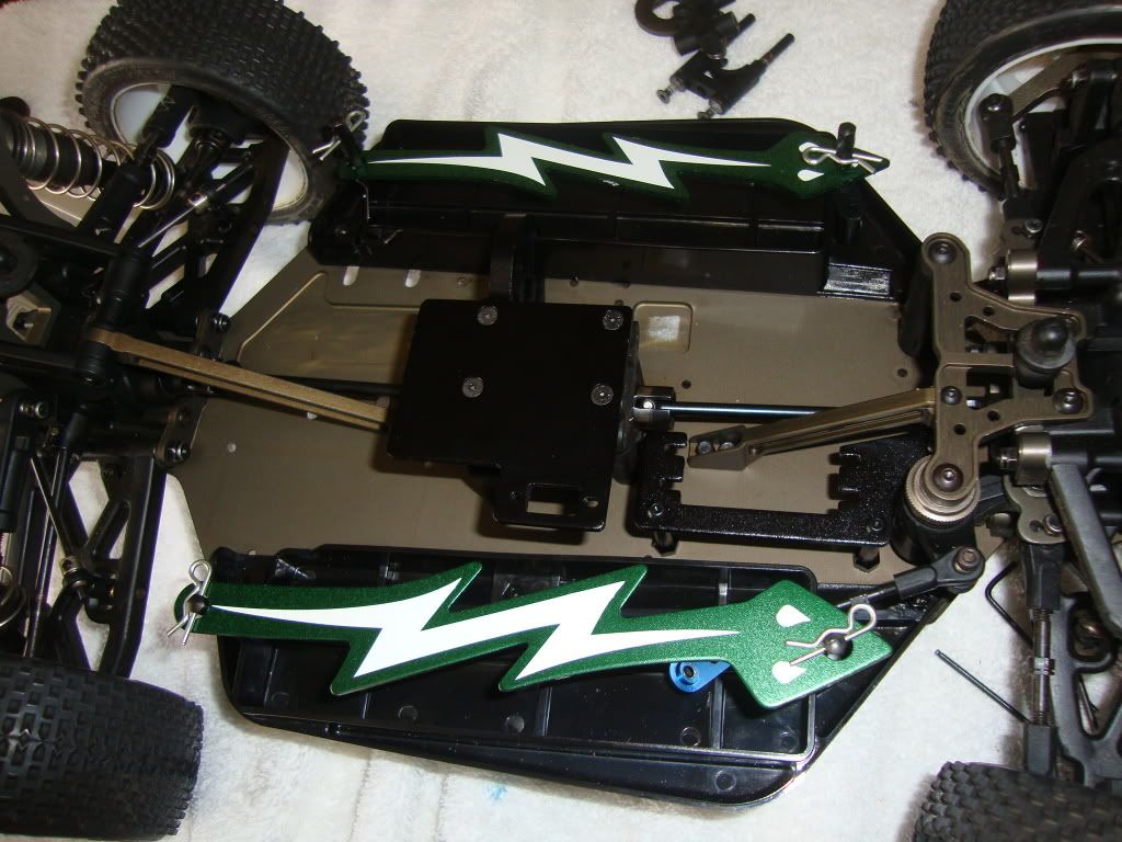

I bought the roller prior to leaving for Hong Kong last October and finally got around to finishing up the conversion. I use Castle's conversion kit along wiht my TeknoRC neu 1515 1Y.

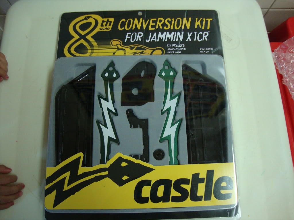

Here are the pictures:

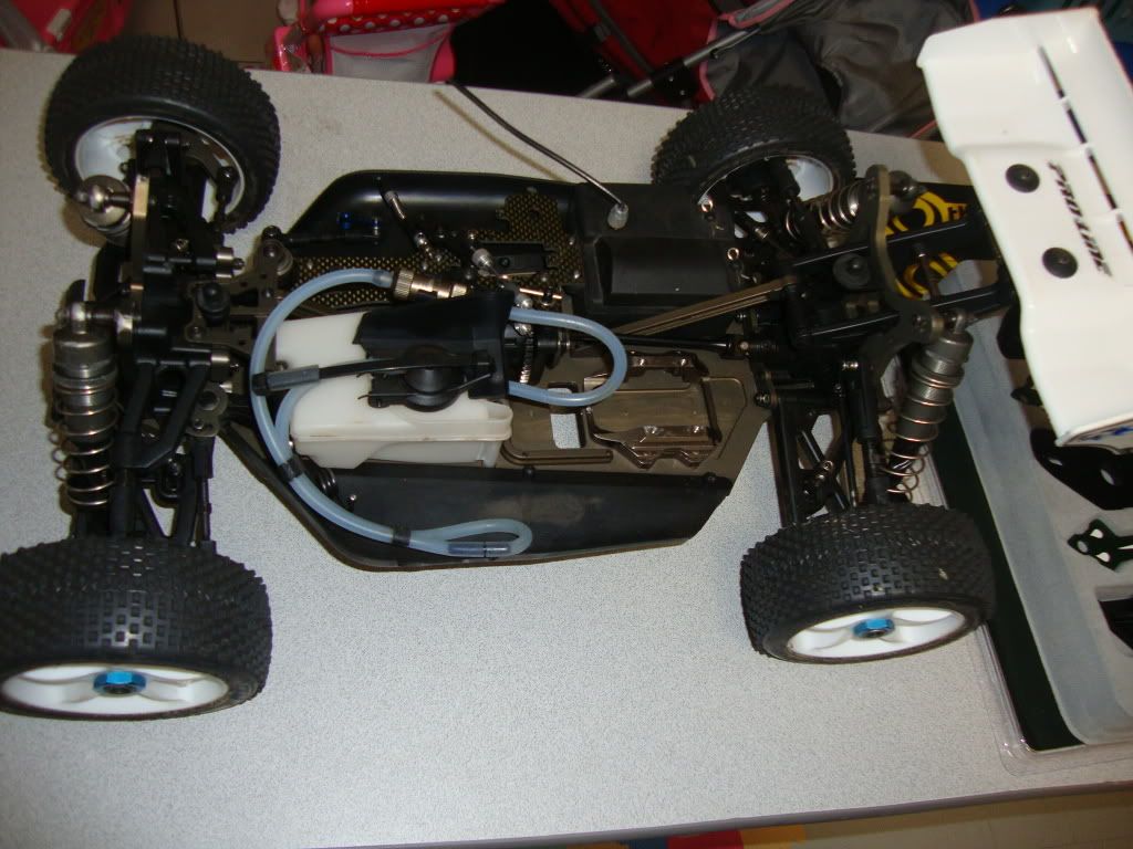

Before the conversion:
CC conversion kit:

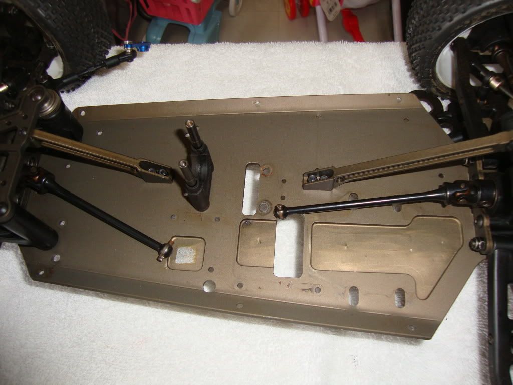

After the clean up:

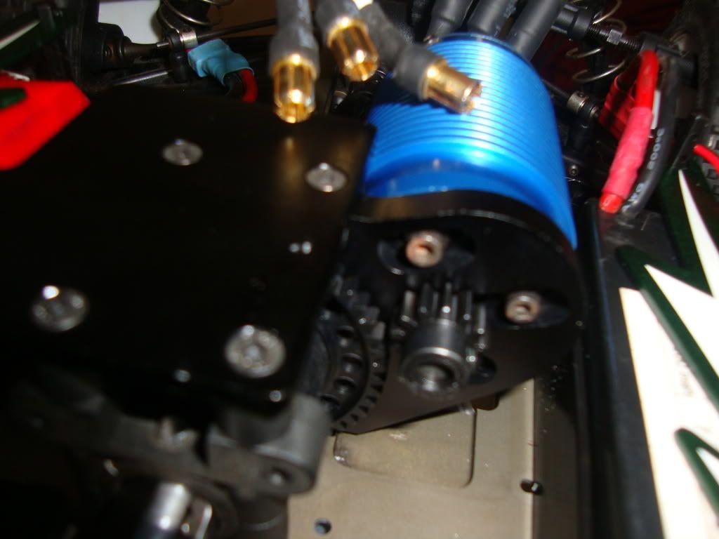

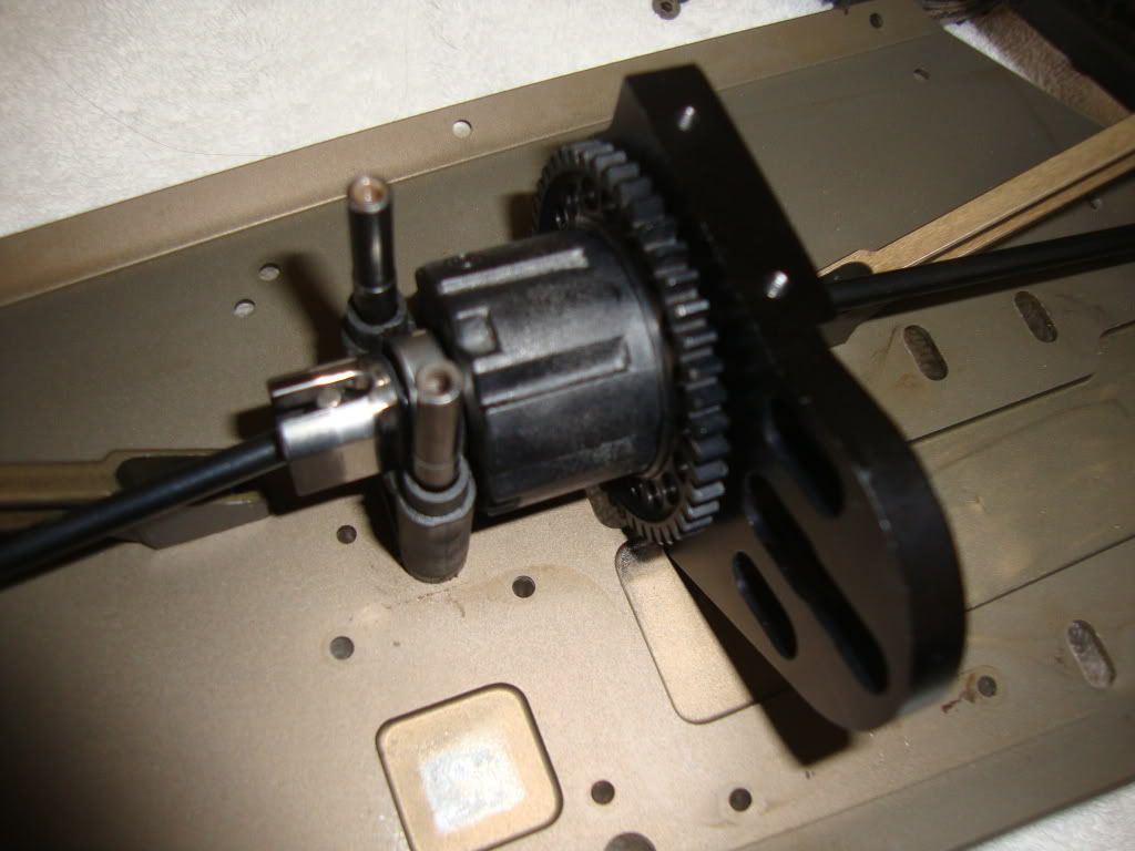

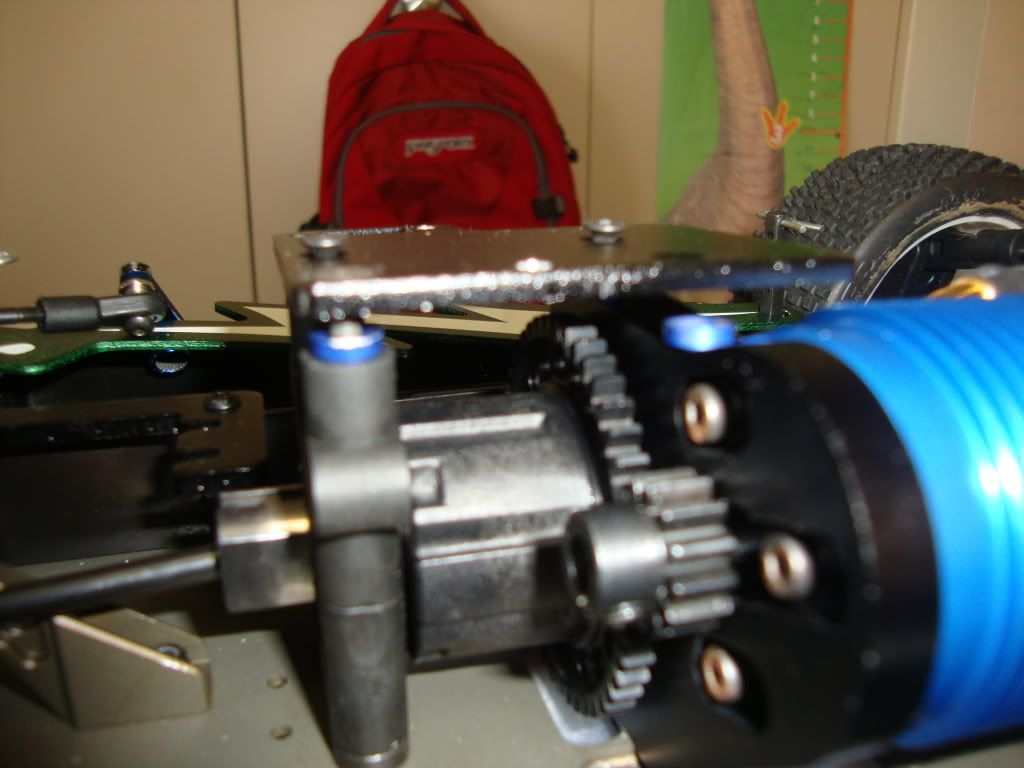

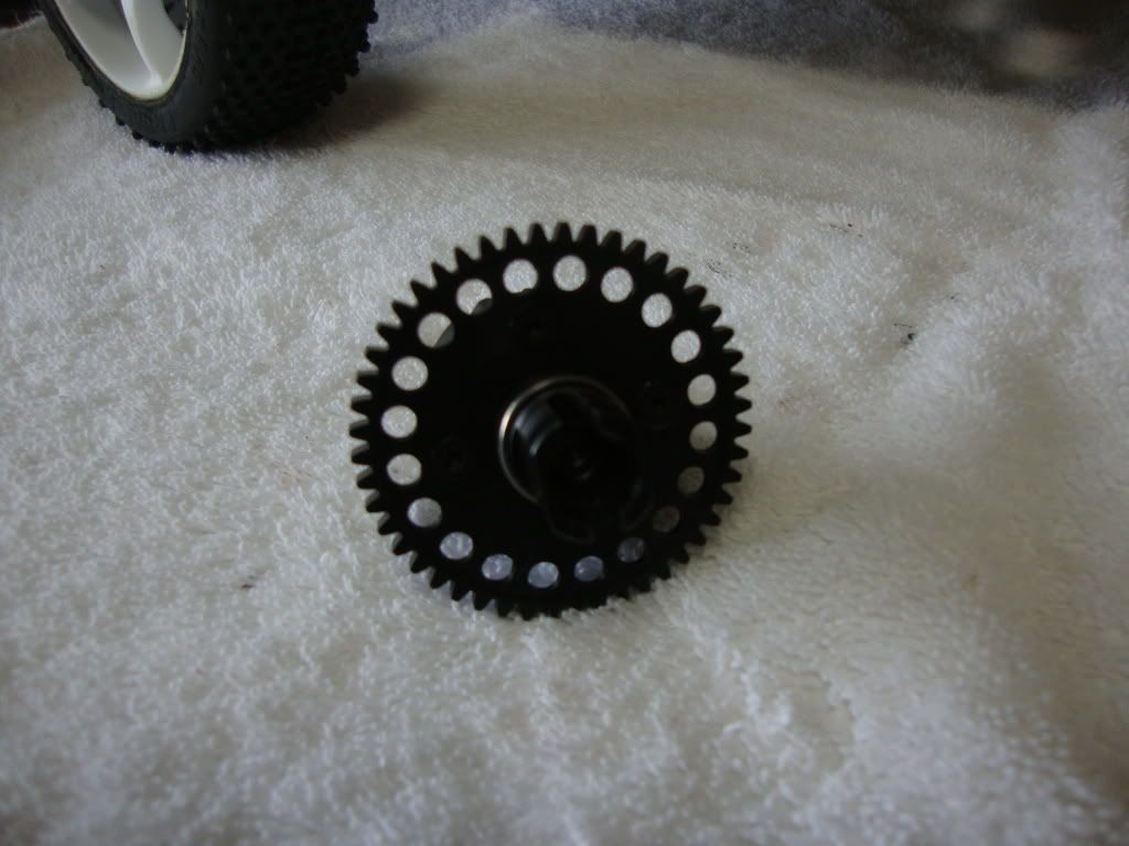

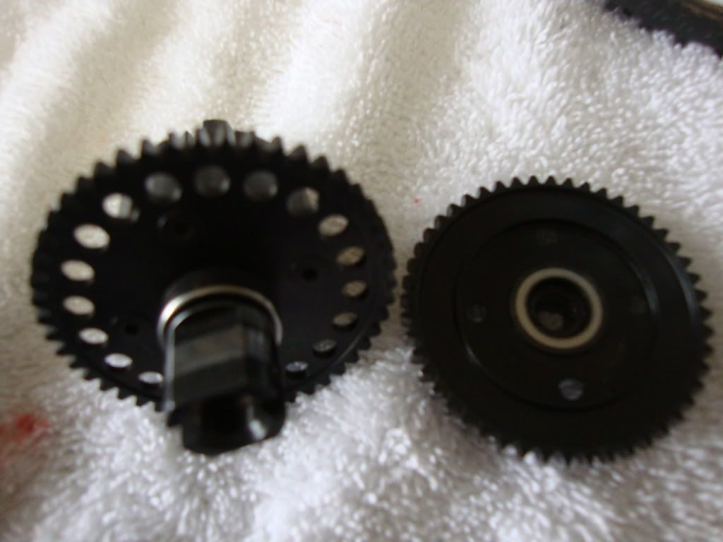

I used my spare 48T lightened Kyosho spur gear:
Mounted the motor mount:

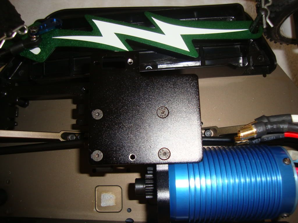

I drilled and tapped the ESC mount. I'll have one made better when I go back to the ship.

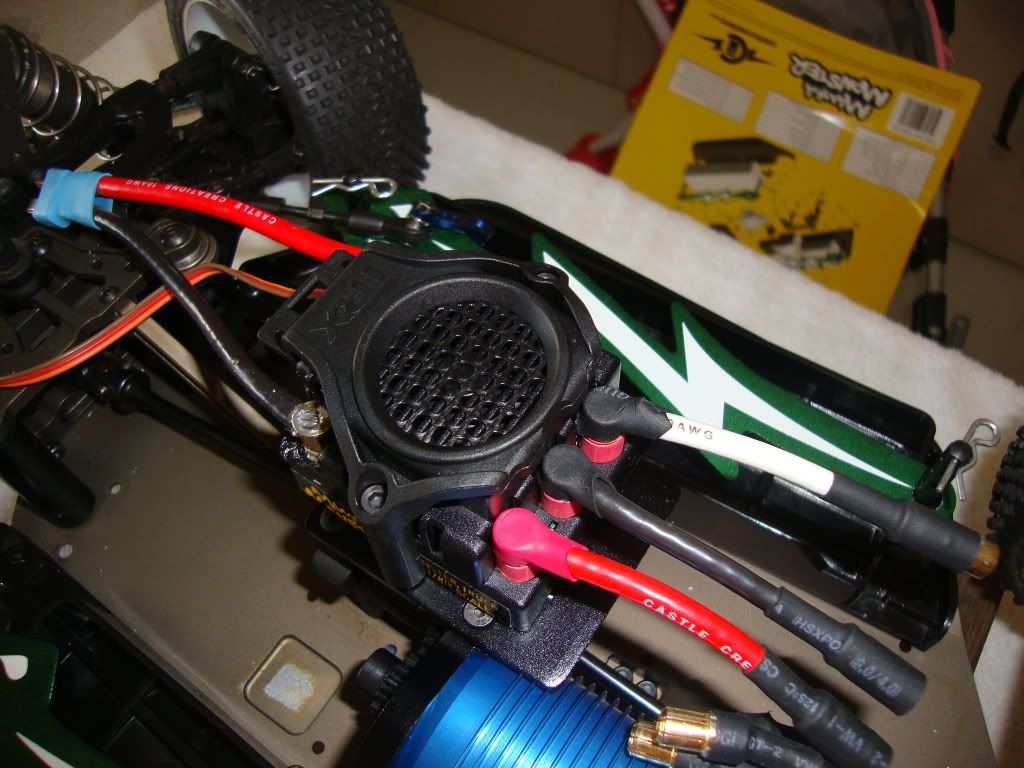

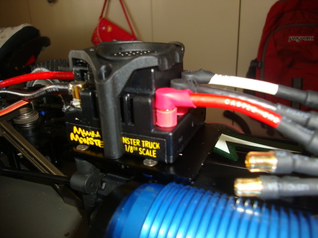

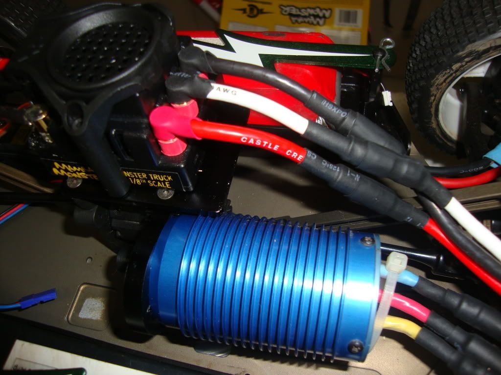

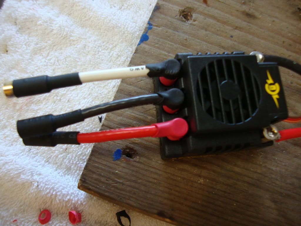

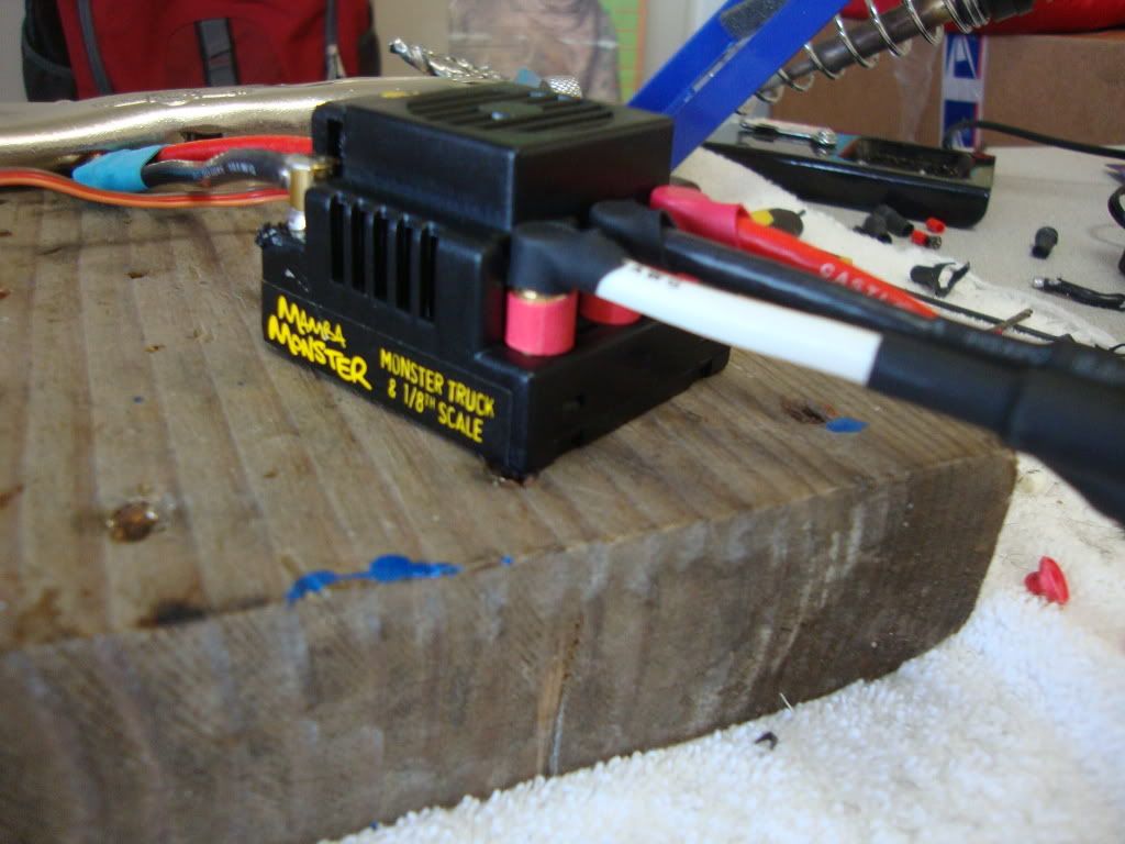

Using the included 13T mod1 pinion did not work well due to the size of the motor. I had to put 3mm spacers underneath the ESC mount so the motor can clear it. This was the refurb ESC I bought from Castle back in August. The power wires were soldered into the bullet probably by someone who does not really want to do it.
Turned the CC 6.5mm bullets into angled ones by enlarging the hole on the side. Turned up pretty well .

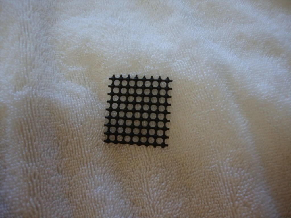

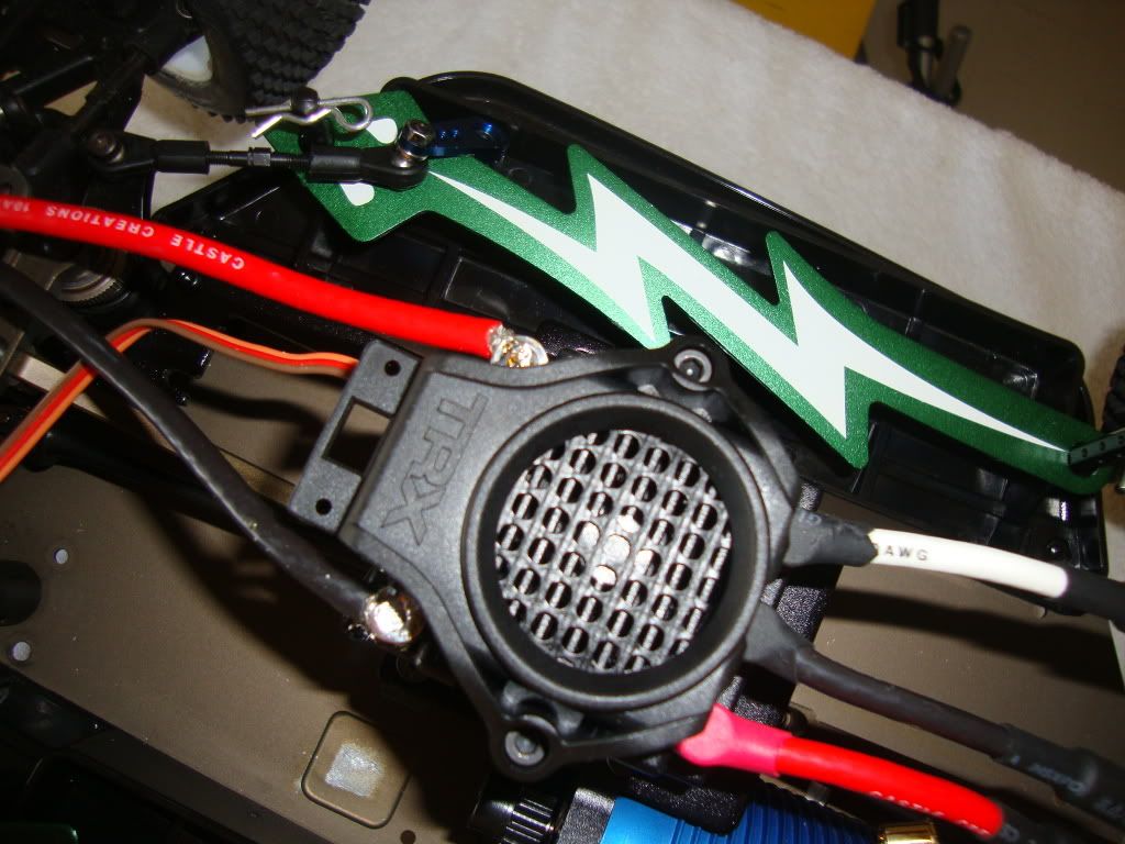

I installed this little plastic screen on top of the fan. It's held in place by the traxxas ESC mount.

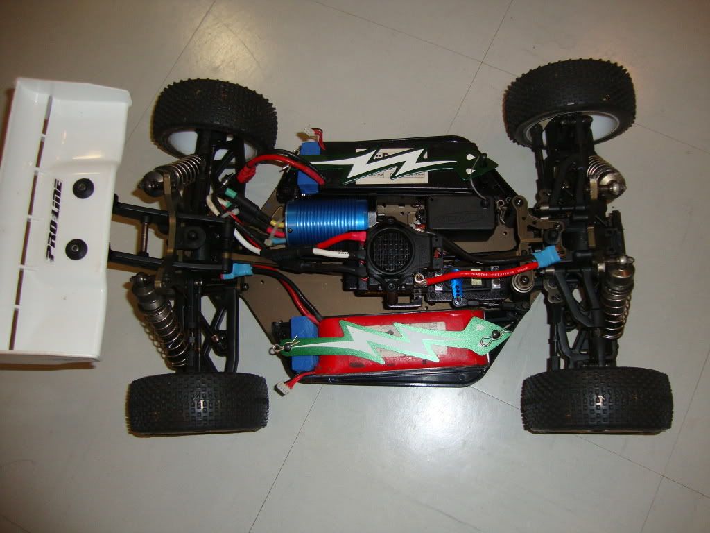

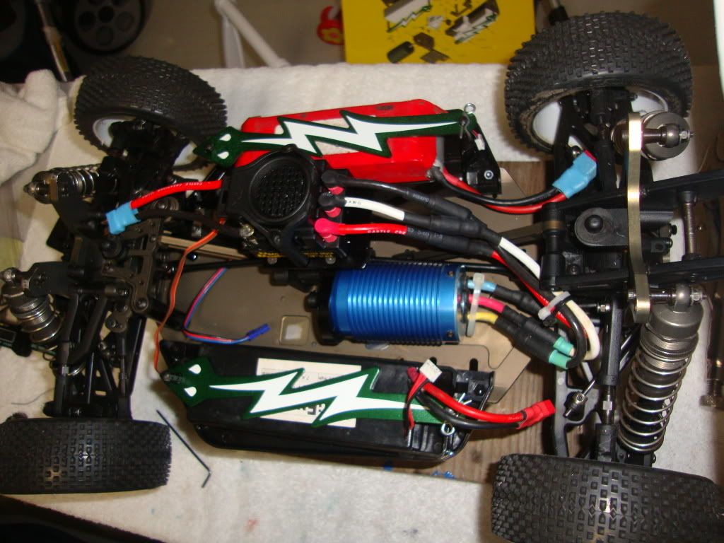

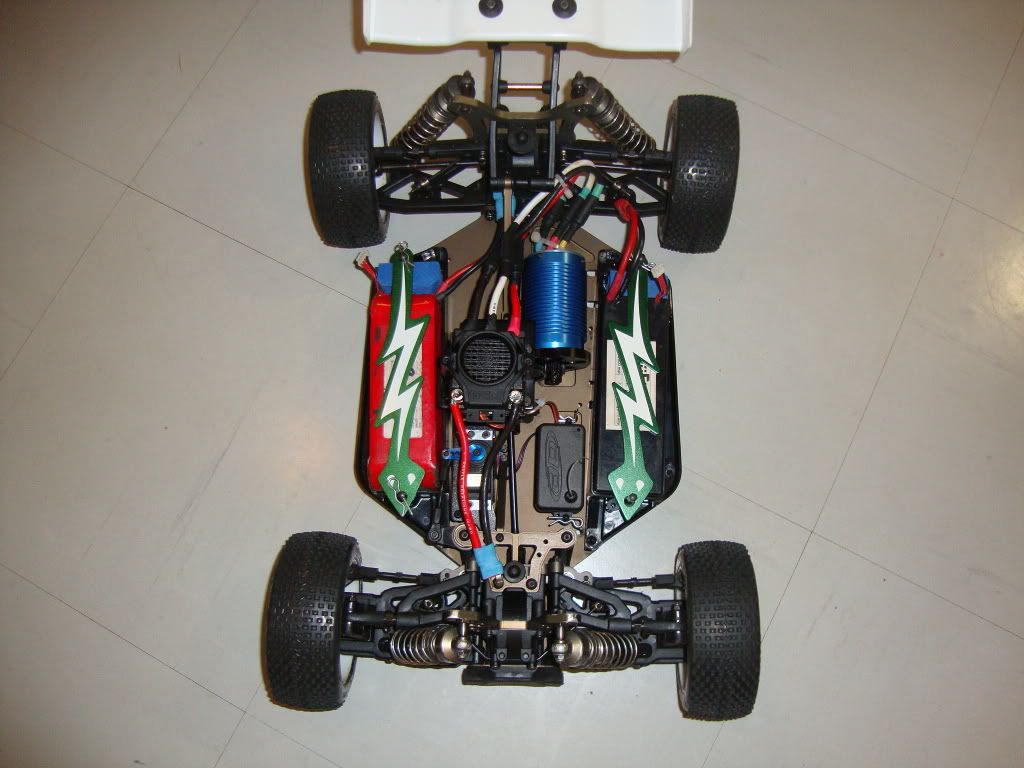

The final product:
Overall, I like the simplicity of the CC conversion kit. However, the battery holders are kind of flimsy for my liking. They are soft and bends easily.

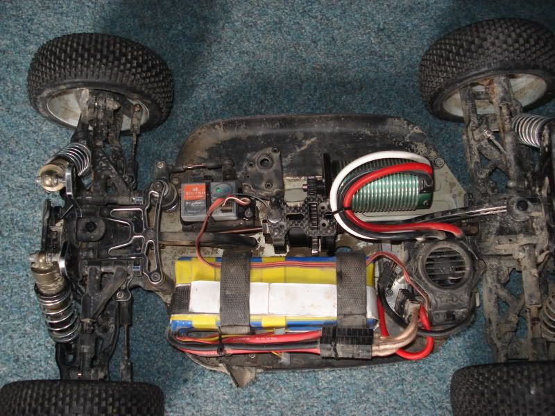

Nice clean layout you got there George. I'm just a bit sceptical about the speed controller on top of the center diff. I've seen quite a few conversions where guys did that as well. I just think it makes the esc way too vulnerable. If you have a hard crash, the first thing thats going to get hit is the esc. Does anyone else think like I do?
Anyway, nice looking setup george. I really like the radio box too. Pity its not an xray...

The ESC has taken a beating already with the way he drives. He's trying to learn how to jump it and there were already a lot of times when the truck landed on it's lid. I just have to make sure the body is on or else I'd be needing a new ESC.

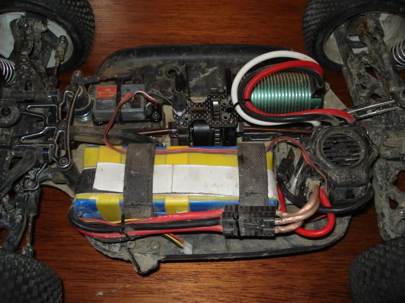

I put my esc behind the battery. Reckon it should be safe there.
Here's a photo:
I had the car out on the track for the first time 2 weeks ago, and got it around the track faster than I could for a whole year as a nitro. Man it was fun!
I'm just waiting on some 4S batts and a different battery tray.
Another shot from above:
This sunday is our last race day for the year, so I'll clean the car afterwards.

im wondering how the layout of the batteries will afffect the handling george, kinda like driving a big brick now... lol
big greg
12.11.2009, 09:57 PM
rampokker, do you have 2 small 4s packs? or are you just running them in parallel for a huge 2s?
No its two 2s packs wired in series. I'm still waiting for some 4s packs.
big greg
12.11.2009, 10:22 PM
really? looks like parrallel to me, you need to split the connection at the esc, is your adapter just -to- and positive to positive
