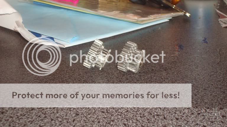

ok, so i'm stripping out drive gears and i don't know why.
the first time it looked like something was not lined up right, one side was stripped and broke off (the teeth were missing) the other side they were stripped but still there. they were very pointy almost wore away completely.
my 2nd one, i put on about a month ago, is gone all the way around the center. there is not much play in the transmission, i tried it when i changed it the first time. everythin seemed to be smooth. i also read that there is no need to put any kind of lube in the transmission, as it does not come with any stock. This is kind of rediculous though to have to keep changing this part.
is there any kind of upgrade available for this gear? i found an aluminum and the stock metal one, however i think it would be bad to upgrade to aluminum, wouldn't that be softer and more easily stripped?
if you have any ideas let me know, this was my first problem ever with the tranny, what can i do to make it my last problem with it?

a little lube never hurts.
The only thing I can imagine is that you have some binding somewhere in the drivetrain. This can sometimes be tricky to pin point, as sometimes bearings only fail under load, but feel smooth free wheeling.
Are you running big heavy aftermarket tires? They really stress drivetrains. Have you added a lot of weight by adding aluminum hopups?
Are you landing jumps while still on the throttle?
You said the 2nd gear lasted a month, did the first one last a lot longer? That would indicate a new problem.
Failing all that, is your slipper too tight? Maybe loosen it a little.

Aluminium would indeed be a bad upgrade choice, not sure what the stock ones are- probably just unhardend steel. Try and find some hardend steel versions from.. somewhere ( hpi forums may have some more specifc info or leads ).

I was having the same problem with my savage and the hd drive gear solved the problem. The stock gear is unhardened steel. The hd gear is hardened steel and will last longer than the rest of the truck.
