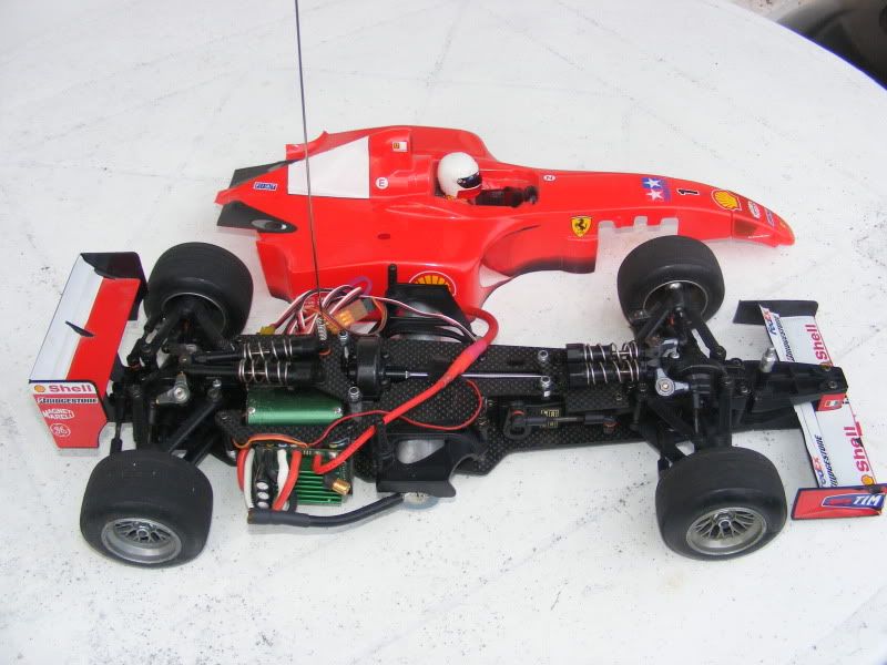

Gday again,
This is my second CC's project. I swapped my Nuova Faor S501 bike for this car and another car I will write about later.
The kit is the Tamiya F104 Pro. Direct drive chassis, fully ball raced and very nice. The car came stock with a Mabuchi 540 type J motor, which I beleive is plenty quick for these cars!! I'm using Castles Mamba Max Pro with the 5700kv motor. Battery is Zippy lipo 2s - 3000MaH @ 30c. It is similar size to a 6 cell NiMh pack. Starting the gearing on 25/104. I'm also using the Lumifly Lighting system, running a single red strobe at the rear, like the real F1's do in bad conditions. The kit came with foams, but I found some rubber tyres to practice as I will be bashing first on the courts.

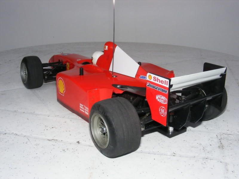

Track shoes - 12.31.2009, 01:07 AM
Shots of the F1 with foams on. Also, if you look hard, you can see the tiny led mounted on the second rear wing. It can strobe or remain on. Plugs into the 3rd ch on the rx.
