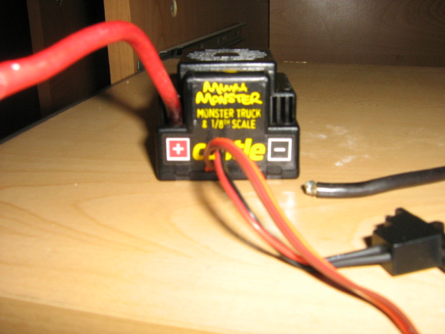

i have had a mamba monster for about 6-7 months now i only have 1 setup run
on it (about 5 mins) it has been sitting on my shelf sins then becuase i
live in canada and the weather got to damp for my liking. i run 2x 8000mah
28c smc lipos with it and today i went to swap out my spektrum RX for a
telemetry RX after changing the rx i pluged in the castle link to check for
updates and updated the firmware to 1.22 after that i went to plug my batts
in and bind my RX and the esc went up in smoke and melted the the black wire
off the esc.
why did this happen i havent changed anything in the 2200kv combo sins the
setup run and now iam out of an esc?

02.07.2010, 05:24 PM
Interesting..
When the esc went up in smoke, was it before or after turning it on with the switch (after connecting the lipos )? Any chance the batts were plugged in backwards (reversed polarity )? Wasnt possibly damp inside due to condensation?
I doubt the firmware update hd anything to do with it, and it updated fine without the bec causing the castlelink to heatup rapidly, so it kinda looks like its one of those random, meaningless failures that happen upon turning the esc on..
Castle should warrenty it for you I imagine, so it will just be a little bit longer before you get to drive your truck again.

02.07.2010, 05:33 PM
polarity was fine and it smokes once i turned the switch on, iam itching to drive this truck it only has the 5 min setup run on it cant wait for the snow to melt, but now i maybe waiting longer

02.08.2010, 02:55 PM
Originally Posted by dracbec View Post
Hey Patrick is this a known problem with the monster or did i just have bad luck and get the one out of every hundred that has problems?
No, from your description, it sounds to me like one of the FET drivers gave up the ghost. It's not a typical failure mode. We only see a handful that fail in that manner.
