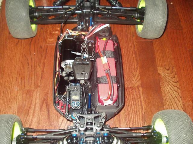

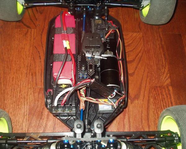

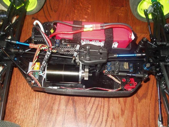

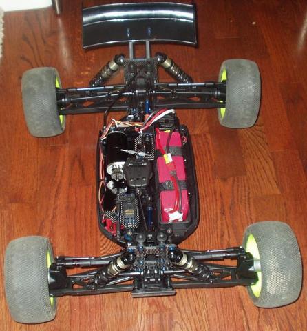

I finally finished my RC8T build tonight.
Mugen center diff with MSR diff adapter and ofna 51T plastic spur
Custom mechanical brakes (Rear only) with hitec digital mini servo
MMM NEU 1515 2Y with NEU Energy 6S 4300mAh
The mugen center diff fits perfect on this truck. I'm just waiting for the RCM slipper diff (sliperential)
The stock shock oil does seem pretty stiff so I'll probably rebuild them with 45/40 f/r
I must say, This kit is well worth every penny. Its soo pretty I'm almost afraid to drive it and get it dirty :)

Didn't see this when you originally posted. Why change to a Mugen Center diff? I never had a problem with my stock CD
