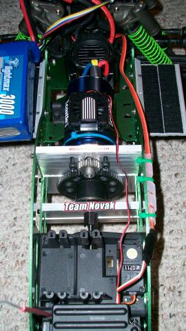

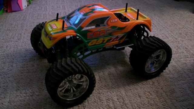

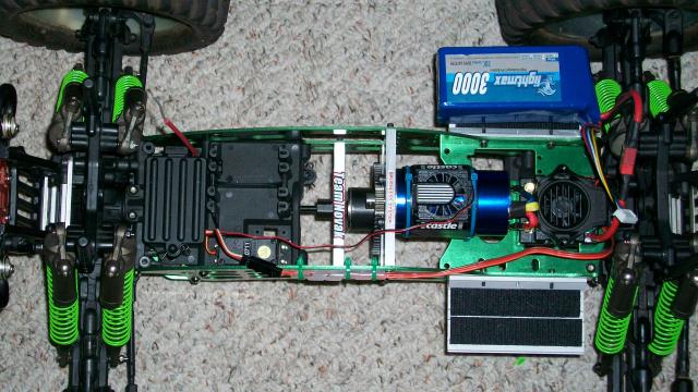

I was just finishing my Cen brushless conversion and decided to post some pictures.The build uses custom cnc machined (by me) center diff housings.I am using a Cen Matrix TR center diff with a 66t spur.I have a 18t and 24t mod 1 pinion gears to try out.The center shafts are from a Kyosho Inferno ST.The speed control is a Mamba Monster esc and the motor is a KB45XL-17.It is a 700kv brushless motor.I plan on upgradeing the motor to a higher kv shortly.All I need are the motor connectors to fit the MM.The truck seems really smooth.Hopefully it all works out well.
