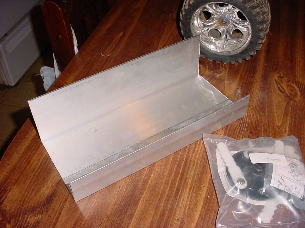

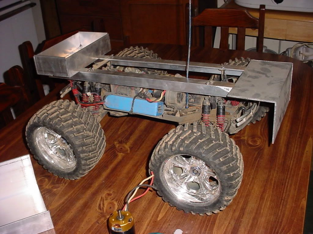

Here we have mounted rails on the body posts, and designed a battery box in the back to help balast the weight of the attachment that will be going in the front. The shocks have been beefed up some, but I have a feeling they will need replaced with much stiffer versions.
The Truck itself is setup on 10,000mah 4S Lipo with a MM modded with a Cap and a CC BEC. The Motor is an AXI 2826/10 12 pole outrunner. Making 920kv, it has a fan mounted that pulls air through the motor to keep it cool. Being geared 20/68, it shouldn't have a problem pulling this, even with the huge tires.
I have a 52 tooth Mod 1 spur on it's way. I may choose to go 12/52 with the gearing. Top Speed is not a priority with this build. In fact, this will be geared in the 10mph to 15 mph range.
Noticed the 4"x4"x 1/8" aluminum angle hanging off the front?
Well here's the rest of the deck that will be hinged from that.
This will form the mowing deck. Trial and error will come into play I'm sure.

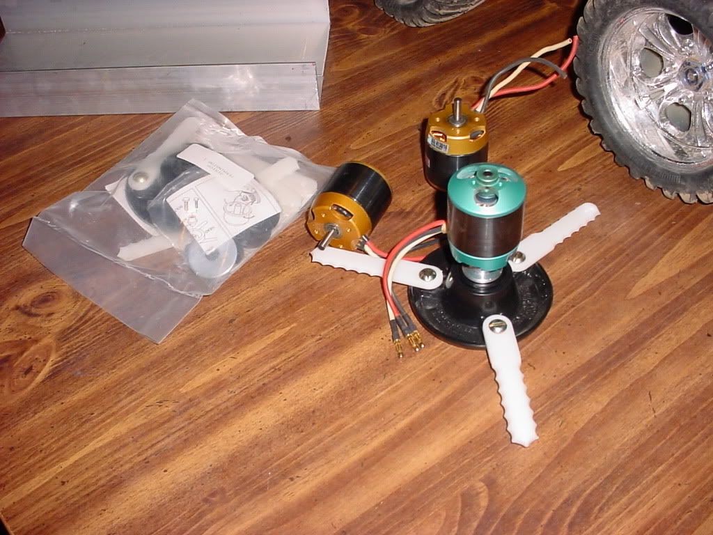

Now for the power plants:
The Blue motor will not be used. Instead, let's go with the gold motors. They are a pair of AXI 4130/16 outrunner motors. On 4S, they will spin the weed cutters at over 6000rpms. They will be powered by a pair of 80amp airplane esc's.
Each motor is capable of about 1.5 hp. I'll mount the AXI cooler fans to the motors to control temps.

I'm using 3/16" aluminum pop rivits to hold everything together. It has a long way to go, but I'll keep you updated as progress develops.
