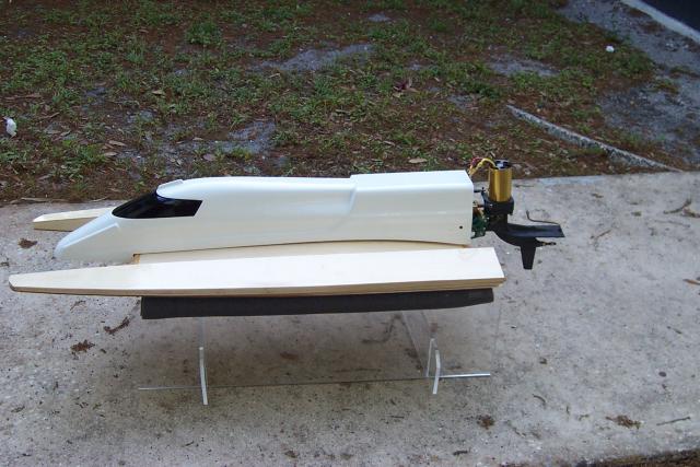

Here is my latest project . I am converting a hitro tunnel to FE.

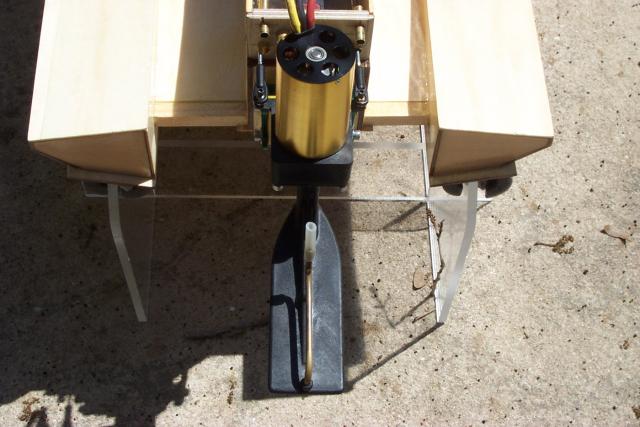

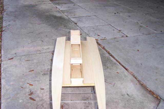

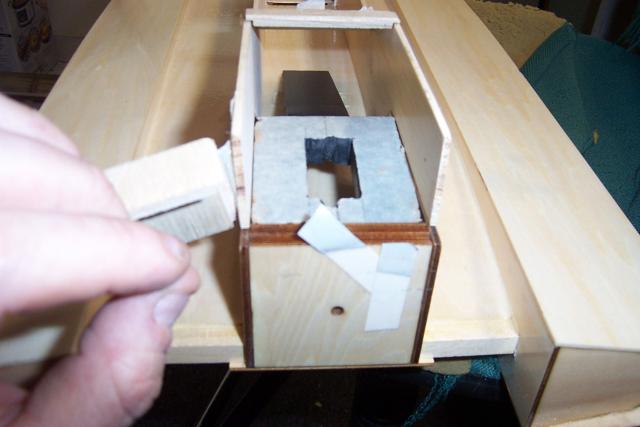

Sorry i forgot about that. As you can see i had to fill in the space between the radio box & fuel tank box . I also had to make it taller to fit my 4s lipo . You can also see my servo & esc tray .

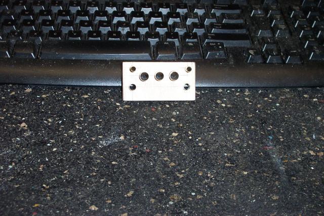

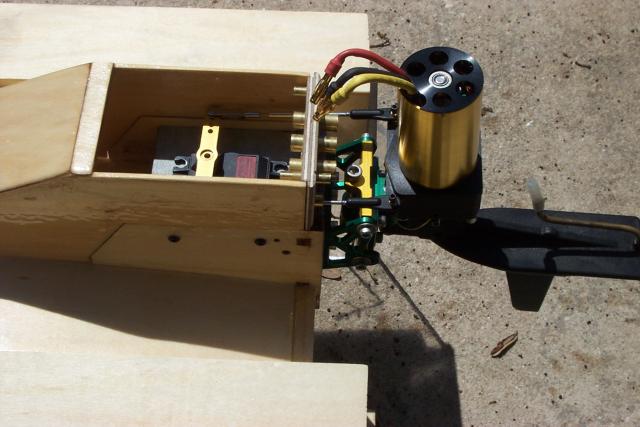

Here are some more pics . Here you can see the new RR plate with all the pass thru tubes. There is two for the linkage , 3 for the motor wires & the top 2 are for the water cooling.

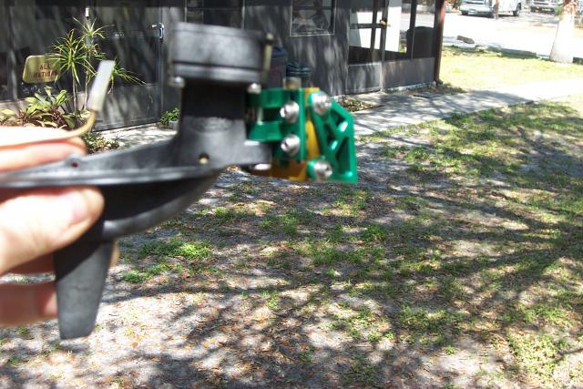

Boat looks good Mike. I like that gangsta mount you have, looks very blingy. Adjustment is key for a tunnel. That mount should serve you well.

Thank's . The mount is called a hi-jack mount . It has four screws that hold to mount in place . when you loosen them then you can turn the screw in the middle . The mount will move up & down like a jack . It also has two sets of mounting holes ( high or low) . So you can offset the mount to either direction . Depending on what hull you have . It sure could use a nice paint job .
