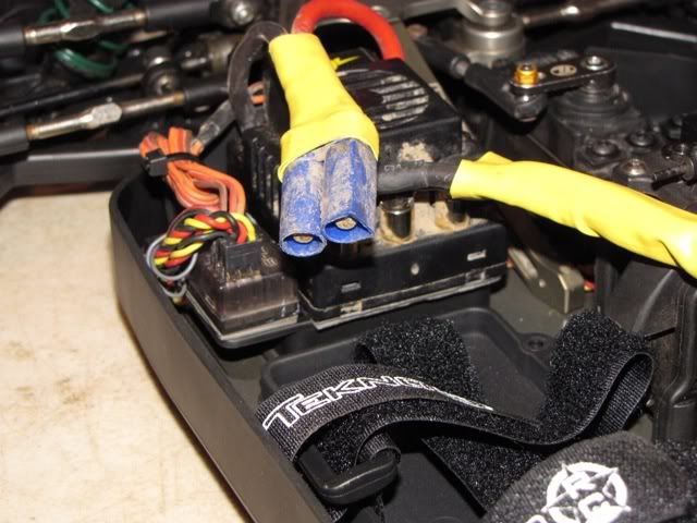

PS I think it's time to update the ESC plate as well.. still using the same one made for a MM esc and it's really too tall w/ the MMM. If you shave off about 1/2 it's at a good height. Then just use some two way tape for the transponder instead and a dirt guard on the front is VERY necessary to keep your ESC alive if you race at all.. especially if there is any rain in the forecast or if they water the track.
Here is a shot of mine.. like I said just an idea but everyone should be doing this iMO.

We've been cutting down the esc tray for years now. We almost always suggest doing this for buggy applications where esc space is limited. We always take suggestions though, thank you. Also, may I suggest using the antenna tube and holder. Spektrum DSM 1 has a hard time working properly if your antenna wire is mixed around other wires and not pointing up. We also recommend using velcro on the battery tray and battery or at least use a small foam pad in place at the bottom of the tray to help keep the battery in place during heavy crashes.
small antenna on the dsm2 allows it to flop and work w/o issues at least on the race track.. so I don't need max range but thanks, funny enough my wires were even in wrong in that pic, I had the brake servo plugged into the bind and the transponder in the aux, lol! Yes I didn't install it yet in the pics (it is now) but I use the 3m dual lock works great, very thin, very light and does a great job holding anything.
