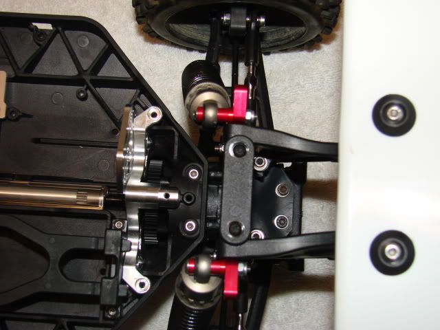

Well here it is. I only installed steering servo as you all know what the esc and motor look like...at least some of you do anyway...
No body as of yet as it will be a mbx-5 body cut to fit
Upgrades
1. titanium pins and turnbuckles
2. ST Racing ALUMINUM towers and steering servo
3. Tekno M6 driveshafts
4. Tekno 17mm hub adapters
5. ST Racing motor mount and center driveshaft
6. FLM front and rear AL diff cups
7. Revo shocks w/Jato springs....( same set up as the crt.5 guys)
8. 1/8 ofna buggy front shocks
9. Revo wing mount
10. Ofna crt.5 front bumper
11. Traxxas center diff
12. Chassis dyed black
13. RPM arms and front skid plate
Electronics will be MMPro w/Tekin SC4X motor on 3s
front bumper supports...out of old slash rear bumper mounts
rear wing mounts...made a small piece ( lower piece ) to tie wing mount to top of gear box cover. I just sandwiched the top of the wing mount to the tower

Thanks I am not a huge fan of the corr trucks per say so i'd thought I would do something a tad different. Seeing as I do not race, it was not a big deal to change this to a buggy. It is so light I am curious to it handling characteristics.
I have not seen anyone using the Revo shocks for the front of theirs either. For those owners of a crt.5, it is the same exact shock set up as many of us run on the crt.5 . So, seeing as I was not using mine, I changed over the front and the rear shocks to the slash.

I actually had some silver rear hub carriers and silver front steering blocks as well. However, had to take that bling off..... to run the Tekno goodies. Although I did contemplate having the AL pieces machined out so I could run them but figured it would not be cost affective.

Forgot to mention one more thing...I added nylock nuts to everything I could...even when the screw was threaded through something. Just a little bit of added security
