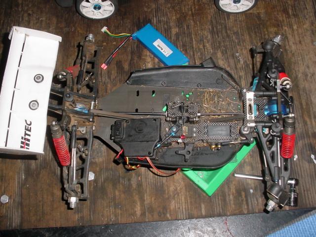

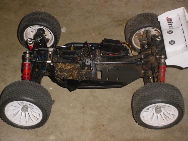

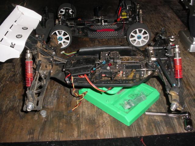

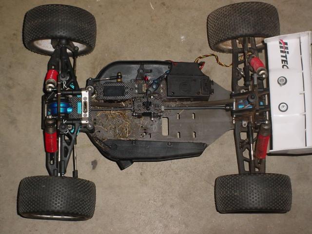

Here are a few pics of the tear down and clean up of the new project: Madness.

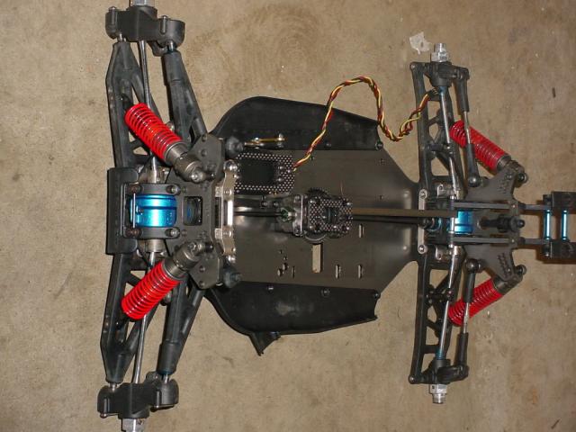

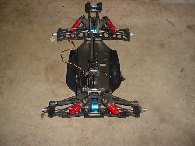

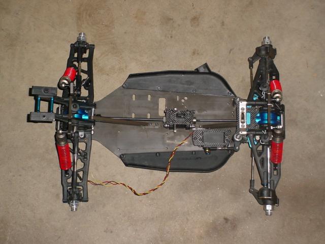

Here are the cleaned up shots:

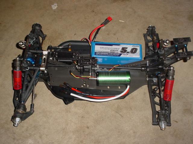

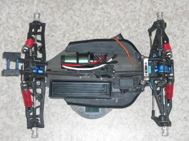

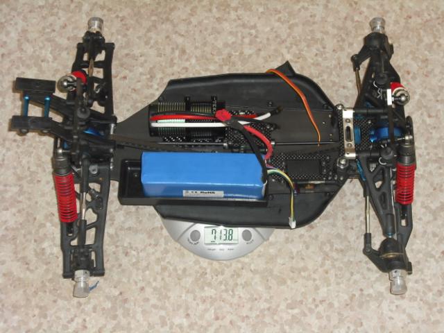

Here is the battery and motor layout.

Is that LST ft/rr diffs?
N. Rustler conversion
10.03.2010, 09:46 PM
The sportwerks mayhem st should use the same diffs as the lst, with muggy ratio gears. Stout for a truggy, but as close to muggy as you will get for drivetrain strength.

Are you sure you want the layout with the huge motor and battery in the rear? You should try to balance it out somehow.
Big House
Big House's Avatar
Posts: 372
11.16.2010, 08:31 PM
Due to the limited space, I don't have many configuration options. If necessary, I will have to add a little weight up front.

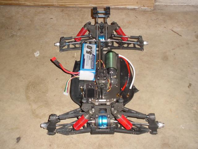

Madness update - 11.25.2010, 02:38 PM
I got he battery tray installed. I ordered one of Mike's battery trays and heat implanted two bolts into the tray so to attach to the chassis. The technique worked well as the I can attach the tray without the screws poking into the side of the battery. The tray also gave me a little room to move the battery forward in the chassis to distribute a little weight though not much.
The motor is mounted, the battery tray is installed, the only thing left is to get the MMM and charge the batteries and we will be in business. Maiden brushless run will be Saturday.
