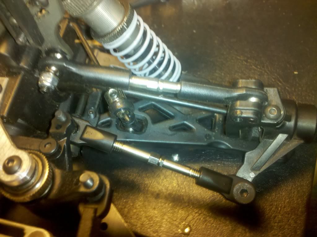

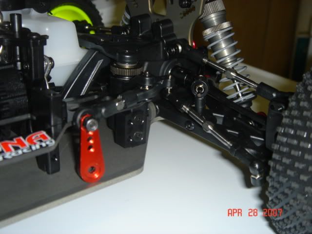

Ok, I replaced the upper arms as well as the steering links. So I figured i would share some pics. I was sick of the upper arms bending at the tiny turnbuckle, or breaking at the same point. I was also sick of the steering links popping off, or breaking the balls(lol)
I tested this setup pretty hard and its holding up extremely good. Best Part is it only cost about $14 total :D I used Traxxas TRA3644 for the Upper Arm, and TRA2444 for the Steering Links. Both are the perfect size, I didnt even have to adjust them. If anyone wants to do this and want instructions let me know, there are a few things you have to mod, but not much. Took me about 15 mins.

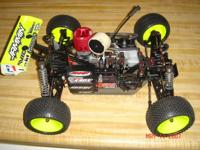

This will also work on the SCRT10
